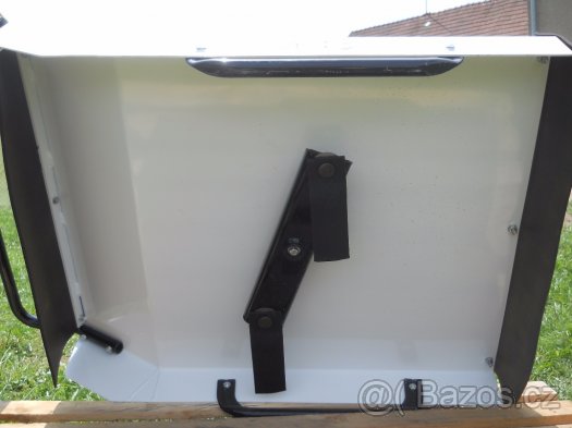

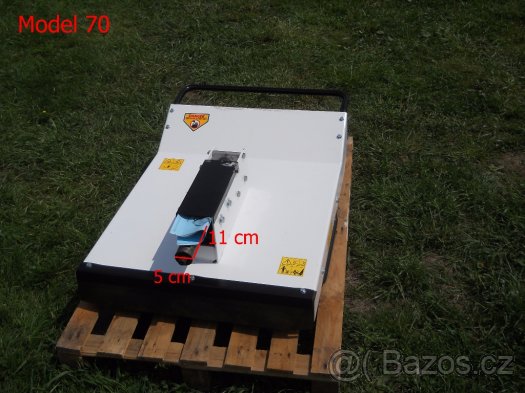

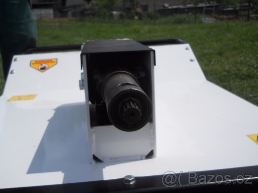

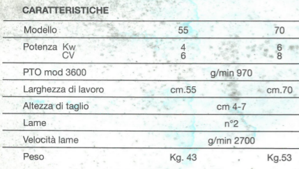

I found someone in the Czech republic selling a an Italian rotary mulcher, 70cm / 28inch wide, brand name YABE-- which I can't find any reference to, though they sent me the user's manual. It looks good to me, although I'll have to get some adapter made for my machine to attach it, but I have the 900-something RPM PTO, and its a better price than trying to get anything from Italy ($300).

I think I saw the old BCS bush hogs were designed like that. Not really the right design for a bush hog IMO. The blades should be attached to a disk. Although that's better than a straight blade, it's not really a bush hog design. BCS America

How far off from the right way is it though?
The other option I see on the used market here is this glorified lawn mower: F-6B mulcher Claims that it can take care of 3/4" saplings and such, or the slightly weaker version, both with the Oregon mulching mower blade. But basically lawnmower.
It is kind of a toss-up to me. But I think the design with the swinging blades-- even if it doesn't have a disc in the center-- is better than the glorified lawnmower blade.

"I think the design with the swinging blades-- even if it doesn't have a disc in the center-- is better than the glorified lawnmower blade. " Absolutely. Just not as good as a disk. But especially if you have already gone through the area, you have an idea of what's in there so you should be fine. Just thought I'd point that out because BCS changed that design.
