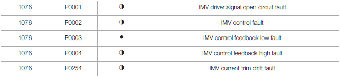

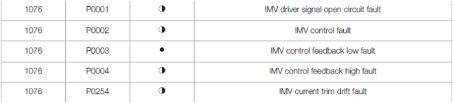

From the manual, it looks like 1076 is related to the inlet metering valve, IMV, which controls pressure to the rail and is connected to the fuel pump. This seems to be used to avoid having a large volume of fuel return to the tank (and heat), but still retain pressure in the rail. Looks like it failed closed/open or is getting a signal to perform in a manner the ECU doesn't like.

or was the F04 displayed also? i.e. F04 1076
that may relate to P0004?

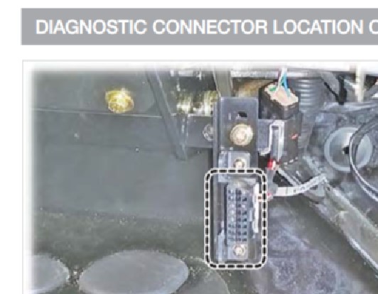

What did he plug it into on the tractor? I'd be interested to know if it is similar to the OBDII protocol for highway vehicles. Perhaps LS would sell the software and interface for the diy mechanic in the future.
   / XR4150H Failure codef04
#9
Behind the lower dash panel is a plug in interface. Yes very similar to OBDII
