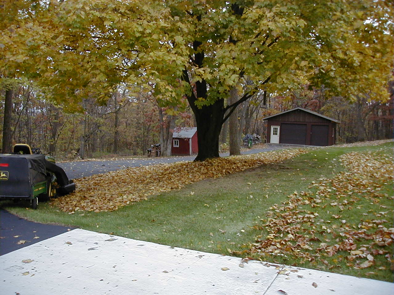

Here is a pic of my X485 with 54c deck and MC519 cart, leaving many leaves still on the ground. They were not the hi-lift blades and the deck did have an added plate bolted under the leading edge. The 445 or 425 with the 54 deck left the ground clean of leaves.
