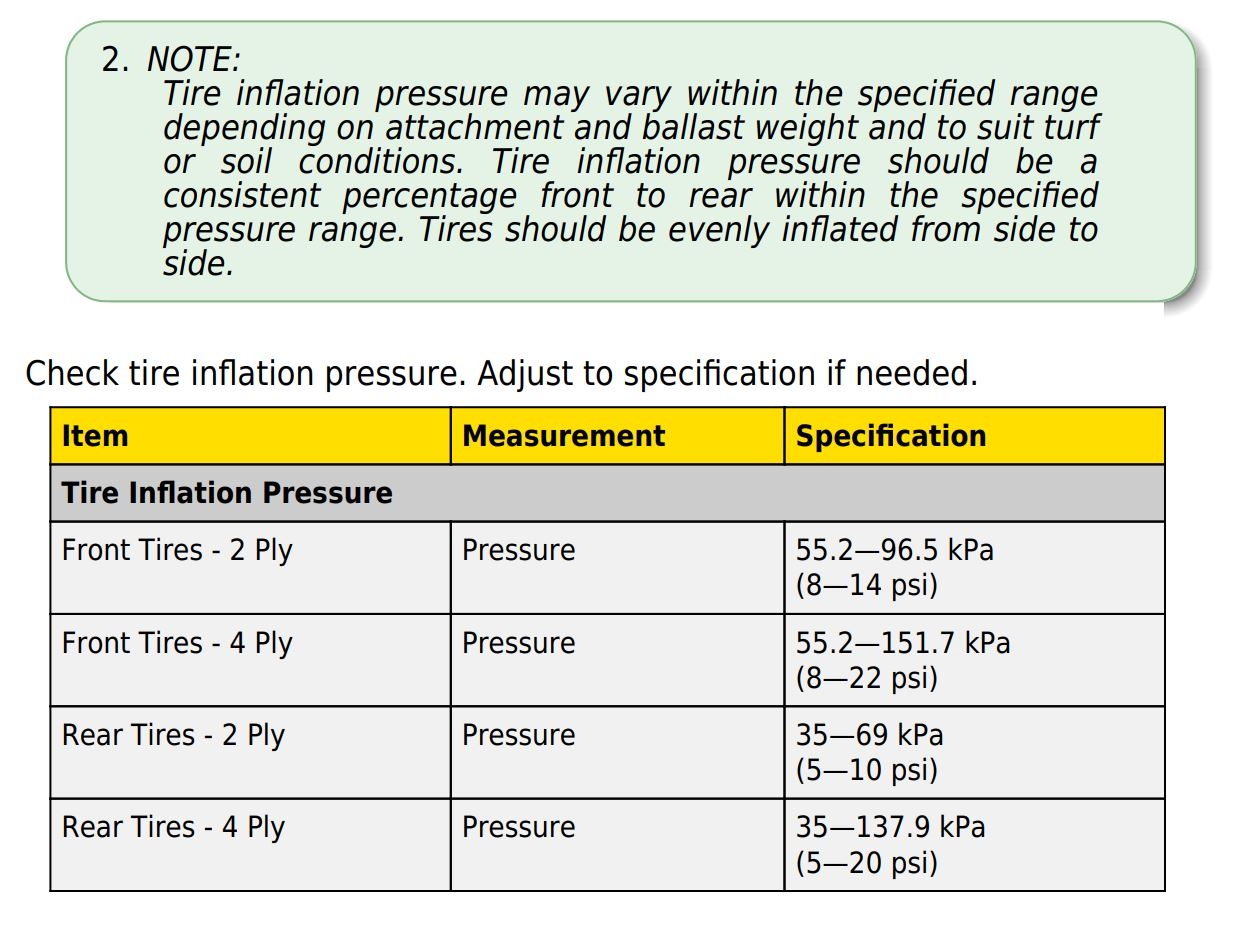

So you also go through the following steps in order ?
1. check tire pressures to be near 15# in fronts and 8# in rears.
2. raise all four deck wheels high as they can go.
3. park on flat surface.
4. set deck height (say 3" ).
5. check that mower blade tips meet at the same height to eliminate a bent blade.
6. measure, with gauge, at the tips of outside blades and adjust both sides to the 3" via hanger bolts #25
7. measure center blade in front and back position to adjust the front draft so the leading tip is 1/4" lower than trailing tip.
8. set desired mowing height on height control.
9. lower deck wheels to as near 1/2" from flat surface (not touching).
Should then be good to go (if I didn't miss anything.. ;) )
I looked in the TM today, and the tire pressure info is a bit more in depth than the manual in regard to specific tire ply. Thought I'd include it on this thread for future reference for anyone else trying to level their deck. Now that I think about it, there may be variance not listed for weight for anything attached to the rear of the machine via QuickConnect or 3PH, same for the front, and in my case, also with a cab on which adds a significant amount of weight. Anyway, here are the ranges:
Source:
TECHNICAL MANUAL
X710, X730, X734, X738
X739 Tractors (S.N. -040000)
TM122719 04FEB16 (ENGLISH)
2-ply tire pressure - Front: 8-14 pounds
2-ply tire pressure - Rear: 5-10 pounds
4-ply tire pressure - Front: 8-22 pounds
4-ply tire pressure - Rear: 5-20 pounds
   / X758 Deck leveling problems solved #79
Timbucktwo
Did you mean "front" instead of rear in your table?
4-ply tire pressure - Rear: 8-22 pounds
