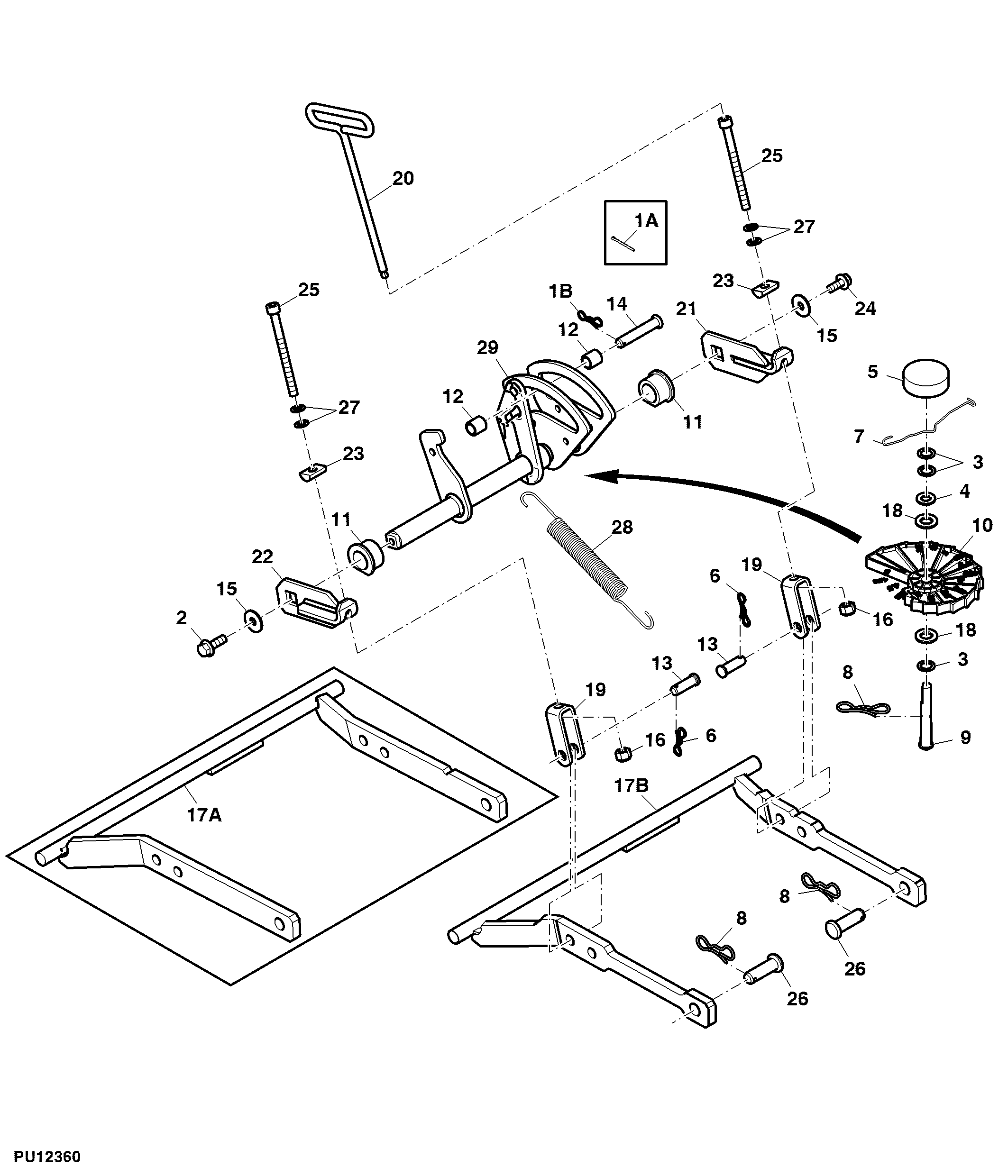

I use the leveling tool referenced in post #25. To level the deck you adjust the leveling bolts #25 with the tool # 20.diagram.gif

/ X758 Deck leveling problems solved #28
So you also go through the following steps in order ?
1. check tire pressures to be near 15# in fronts and 8# in rears.
2. raise all four deck wheels high as they can go.
3. park on flat surface.
4. set deck height (say 3" ).
5. check that mower blade tips meet at the same height to eliminate a bent blade.
6. measure, with gauge, at the tips of outside blades and adjust both sides to the 3" via hanger bolts #25
7. measure center blade in front and back position to adjust the front draft so the leading tip is 1/4" lower than trailing tip.
8. set desired mowing height on height control.
9. lower deck wheels to as near 1/2" from flat surface (not touching).
Should then be good to go (if I didn't miss anything.. ;) )

If your levers are level now you should be able to level the deck in the middle of the range of the adjustment bolts. I don't know what kind of locking feature deere has built into this adjustment but if the bolts are moving maybe the half moon blocks the bolt screws into are not holding the threads tight enough. Item 23 in the parts catalog you posted.

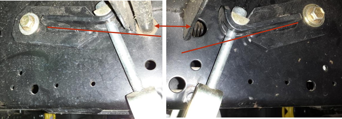

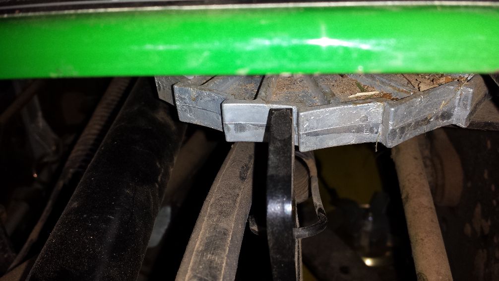

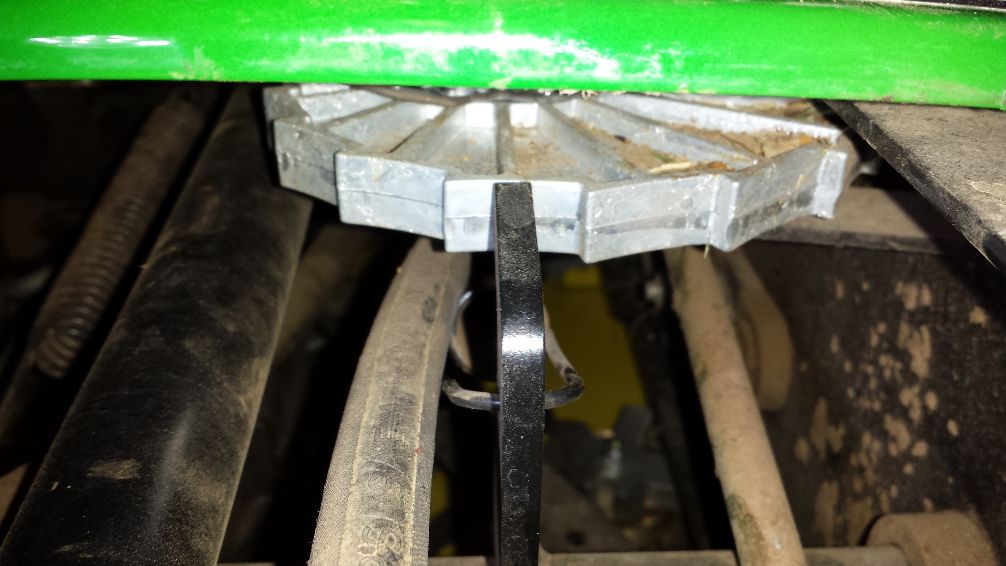

Resurrecting an old thread with an issue for me that has never been resolved. My x750 mowed so bad that I resorted to using a walk behind on my front yard. I got tired of walking the front so I bought a Scag to mow with. Anyway, I bought a CTC loader for the x750 and while I had it apart to install the THRV I saw what may very well be my problem.
As I've said before in this thread the levelness of the deck seems to change on the fly. The pics attached show the deck cam adjuster where it makes contact with the rockshaft. The rockshaft should contact and stay where the steps are keeping the deck level, but as you can see there is evidence of movement. The deck cam is keyed so there's only one way to install it. I'm thinking that the rockshaft could be bent or twisted. I bought the machine used and the previous owner installed the three point hitch.
