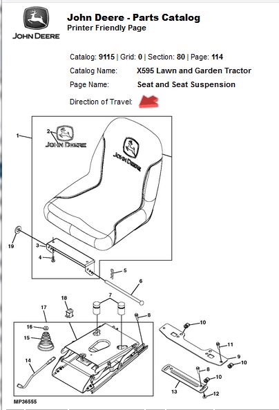

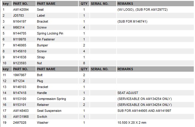

There are a few styles of seat switches:
1.) Plastic lever arm switch - These are known to break (lever arm) or the switch corrodes out. Hardest to replace because you have to tear the seat apart to replace.
2.) Seat frame mounted push button switch - known to corrode internally due to being more exposed but easier to replace.
3.) newer style air bag pressure switch - these are pattern after the car seat sensors, that arm the passenger air bags systems. So which do you have?
So it depends on whether you still have the original seat. Looks like the exposed type seat switch from the john deere parts site. I'm attaching illustration and parts list.
I would clean connections on the seat switch plug. Also look at brake switch also, since these could be daisy chained (series wired), Finally the PTO switch. Oh you have the famous ignition key and module, look at the fuses and the lights this will also be a key to what is going on.
