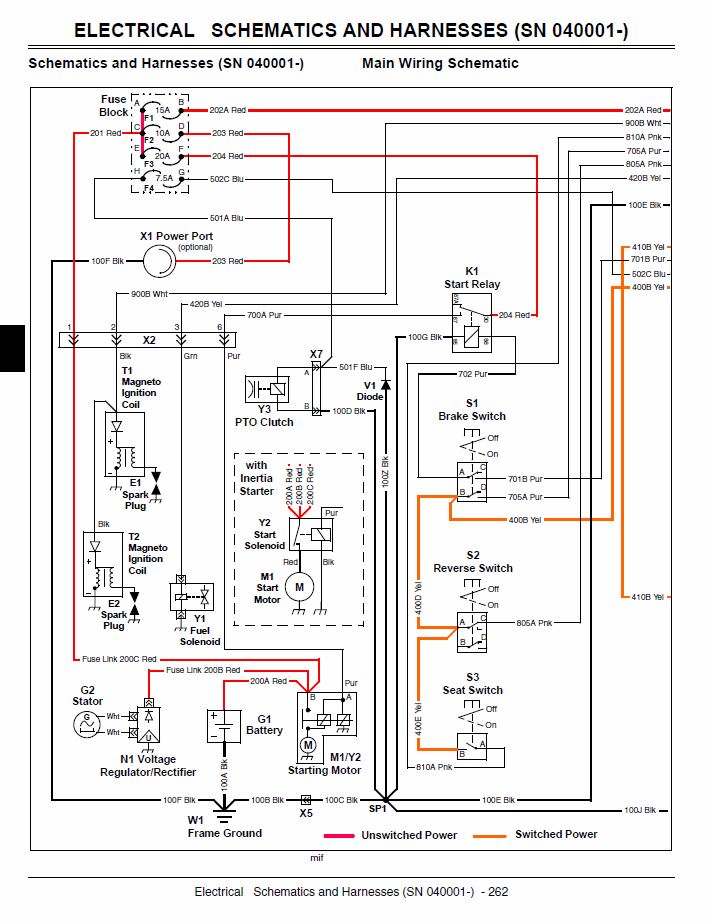

The B lead in the connector should be chassis ground... period. a point previous to X5 may be an open connection
assuming the diagram posted and linked is correct....
the A lead in the connector should be battery + voltage and since the diode is reversed biased should not reduce or affect the DC + available at that terminal.
that said I would back probe B terminal with a jumper to battery ( - negative terminal ) while everything is hooked up and PTO set to on with all conditions normally met for a functioning running PTO and see whether the PTO Clutch locks up and spins the PTO
I still have doubts since the same X5 is also the ground for the starter relay...
You may also want to check the outgoing Voltage and fuse itself
7.5 amp fuse 502b (blue wire) incoming to fuse and see if the test light comes on when trying to start PTO test light alligator clip to good ground.
ps. after all of the suggested help if that that fuse is just bad :confused2::laughing:

Ok. Well let's go back a bit.
Dan's post in #21 is good info. Do you understand all his terminology? Just say if there are any words/terms you aren't familiar with the meaning of.
Ditch the multimeter for now.. The test light probe is all you need initially. You just need to know if you have voltage...
Connect the alligator clip directly to the battery negative (-ve) terminal. Not the chassis or any old bolt-head. The battery is the source of the power and you need to know power is going back to it. OK?
Now to test the PTO clutch initially, disconnect the 2-wire connector (X7) under the chassis. You then need someone on the seat (weight) - or to jumper the seat switch (for testing purposes only).
Key switch in the Run position or Run-&-Headlights position. (That's Power ON)
Brake pedal released.
Insert probe into the A terminal of the X7 connector which has the 501A/F BLUE wire.
Activate the PTO switch.
Does your test lamp glow?
Don't move, change or do anything else but:
Swap probe point to the 'B' terminal of that same X7 connector with the BLACK wire.
Does your test lamp glow again?
Report back here.

The test light being self powered explains some of this... I (***-u-me-d) it was just a basic 12 volt (in circuit) powered incandescent style test light.
It sounds like we are now back to No input Voltage to the clutch A terminal, (your results for multimeter test under the normal all conditions met) for clutch lock up state.
A test that would be helpful would be to check Connection C 370b at the control module for 12 volts when PTO switch is set to run and (key switch set to run) , if there is no voltage available the PTO on /off/momentary switch itself may be bad.
EXCEPT
for post 6 and 8 which clearly sound like an Open ground from clutch b terminal... You measured 12+ volts at the clutch input A and then measured in post 9 a .54 Volt difference between the A input terminal and B (GROUND) terminal??..
This sounds like an open ground
I would suggest Doing that test again With the connector plugged in.
and also a Voltage test between B terminal and the Battery ( - ) terminal (once again all conditions met for a running PTO)
If this shows anything much over 1/2 volt then the ground path is open.
Hope this helps, and a bit confused by some of the test readings.

Well guys, the tractor and deck are running. After all the tests, I decided to look at a new wiring loom. Much to my surprise there was a used one on E-Bay that came off a running X540.
I just got it swapped out, and low and behold, it fired right up and the deck runs. I used my old electronic module on it, which I didn't think was bad but couldn't think of anything else. There must be a broken wire somewhere in that old loom.
