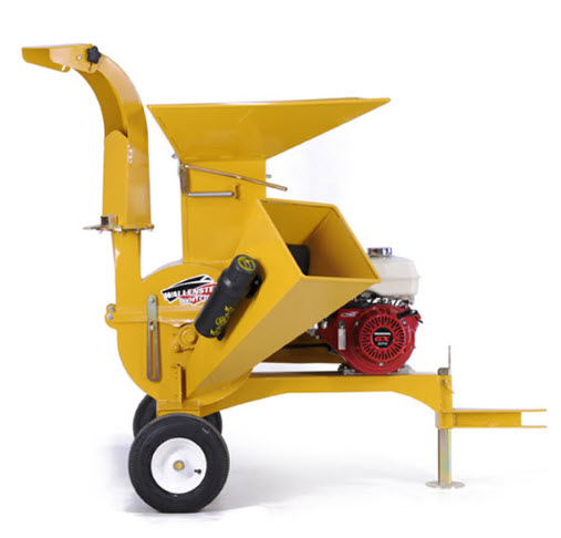

Given the expense of adding the PTO and 3PH hardware in addition to the possible transmission issues, it may be more wise to simply get a small towable chipper/shredder that has it's own small 8-13HP engine that you could easily pull around with your X485.
Wallenstein makes some VERY nice small self-powered units that are nearly identical to their PTO-driven units. They aren't your normal big box store variety.

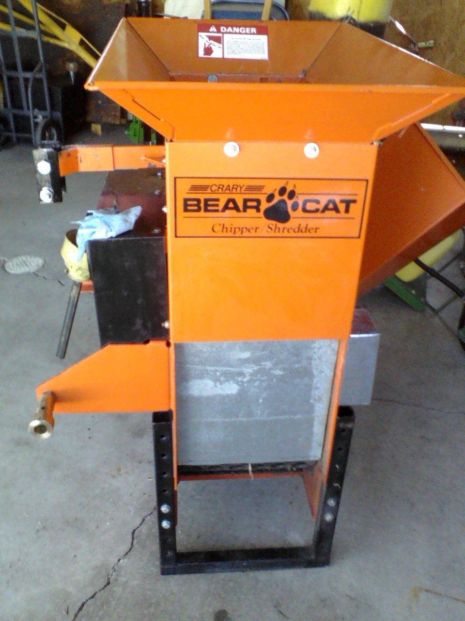

Sounds good. You might find that you need to go bigger than the 1-series as most chipper/shredders (even the small ones) require at least 25HP on the PTO. The smallest Wallenstein and Bearcat models recommend 25-45HP. A small chipper-only can sometimes get away with 15 PTO HP.
Those big 75-150 lb. flywheels can wreak havoc with your PTO clutch and brake.

The Woods 5000 PTO chipper/shredder requires 15-40 PTO HP. I ran one quite well with a Deere 790 (23 PTO HP). This chipper/shredder (made by Bearcat, BTW) can handle up to 5" limbs...anything smaller is, of course, easier. Great implement for small farm or estate use.
In LNW's situation, I'd definitely go for a tow-behind machine. By the time he puts the money into modifying his X485, he could have put the money toward a powered chipper/shredder that would likely do a better job.

Thks for the feedback! Have spent some time tonight reading up on the Wallenstein pull type units and am impressed with what I read. Think that the 3213 model might work well on my acreage. Will check it out at the dealers next week. Also like that it's a Canadian company - support local ! Anyone have experience with that unit ?
