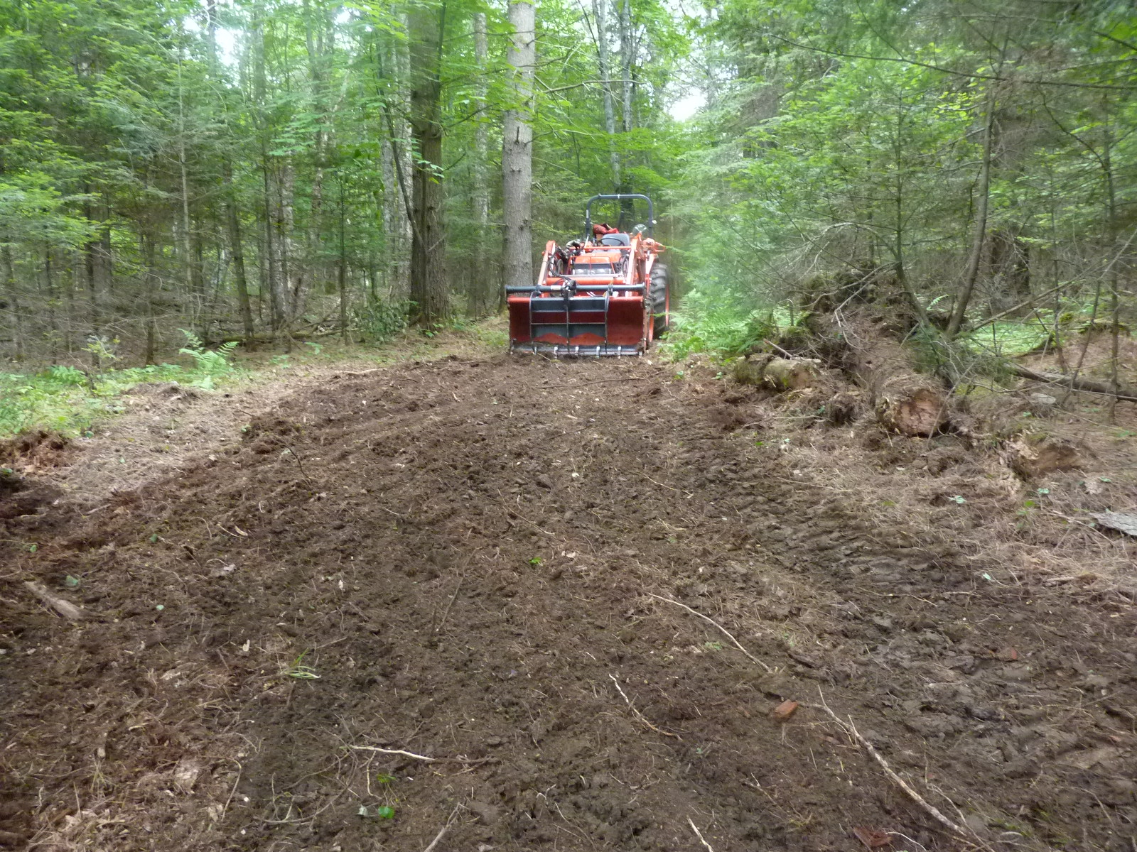

I have two Piranha's... one on a 6' bucket and one on the 60" bucket in the pic. Two different tractors. They work excellent for doing cutting into sod, ripping out bushes and digging in dirt. They are also excellent at back dragging. I never take them off.
My friend has a Long tooth bar on this L39 Backhoe. He hates it. Terrible for back dragging. I have run it too... it works good for digging but no good for back dragging... and I think the Piranha digs better.

The teeth hangs down below the front of the bucket on his loader. So the bottom is no longer flat.
Here's a pic that shows teeth hanging below. ImageUploadedByTractorByNet1482255585.221457.jpg
/ WR Long vs Titan Tooth Bar #20
I back drag with my WR Long tooth bar all the time. I think it is easier and makes a better job with a tooth bar vs just a cutting edge. You can make a flatter surface by exposing the teeth to scarify or groove the area and then hide the teeth to fill the grooves with the loose material.
