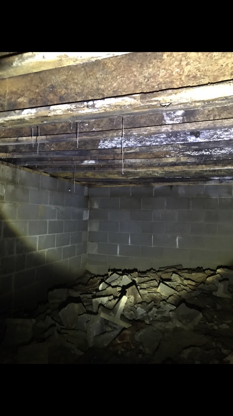

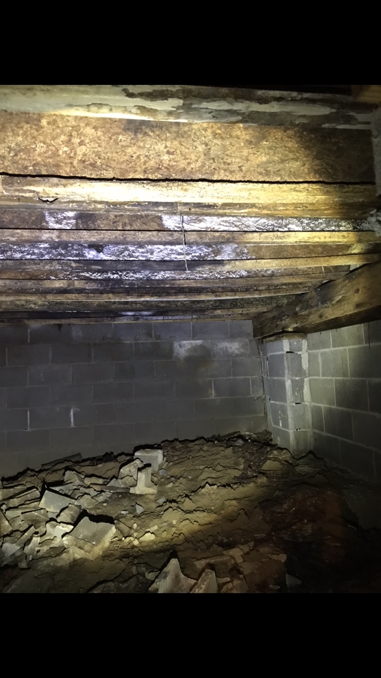

I haven稚 calculated the load rating of the joist. Considering the concrete didn稚 break and the joist didn稚 sag during the pour maybe they didn稚 do awful in that aspect. The biggest flaw was they didn稚 have any other support for the concrete and they used a product not meant for wet location in a wet location. If the concrete had any means of support that didn稚 rot away it probably wouldn稚 have fallen in. View attachment 587336View attachment 587337
That's about ready to collapse. He has no choice but to rip the slab out and replace them. Best option would be to fill in the cavity and then repour the slab.

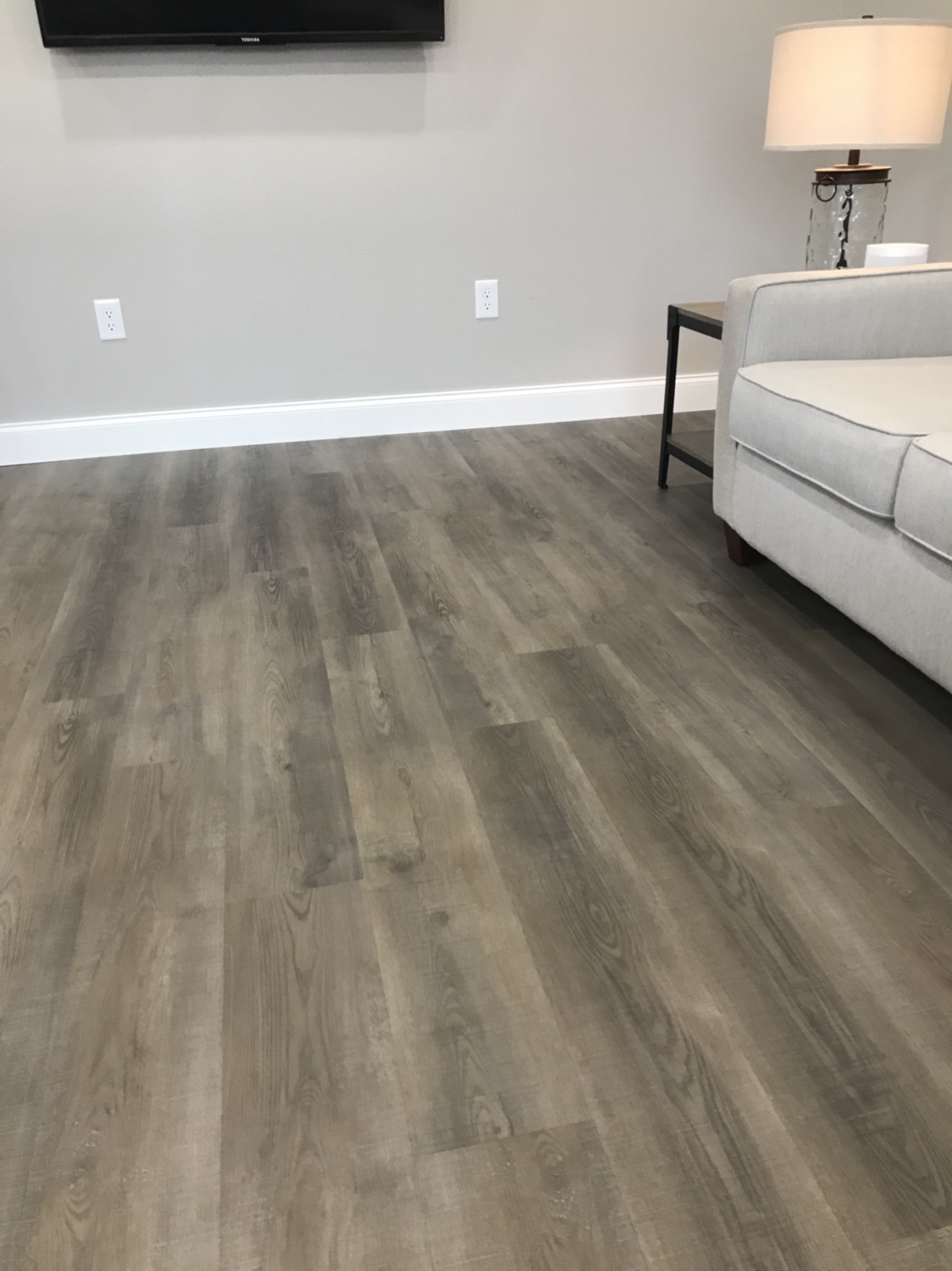

Exactly what I think, but he wants a wood floor. Here’s an office I did that had a concrete floor. That’s a vinyl flooring product that’s water proof and approved for direct contact with concrete. Maybe he’d go for that. I’m guessing it would cost close to $1500 to fill in the hole so I need to look into better methods of supporting the concrete while leaving it hollow. IMG_1222.JPG
