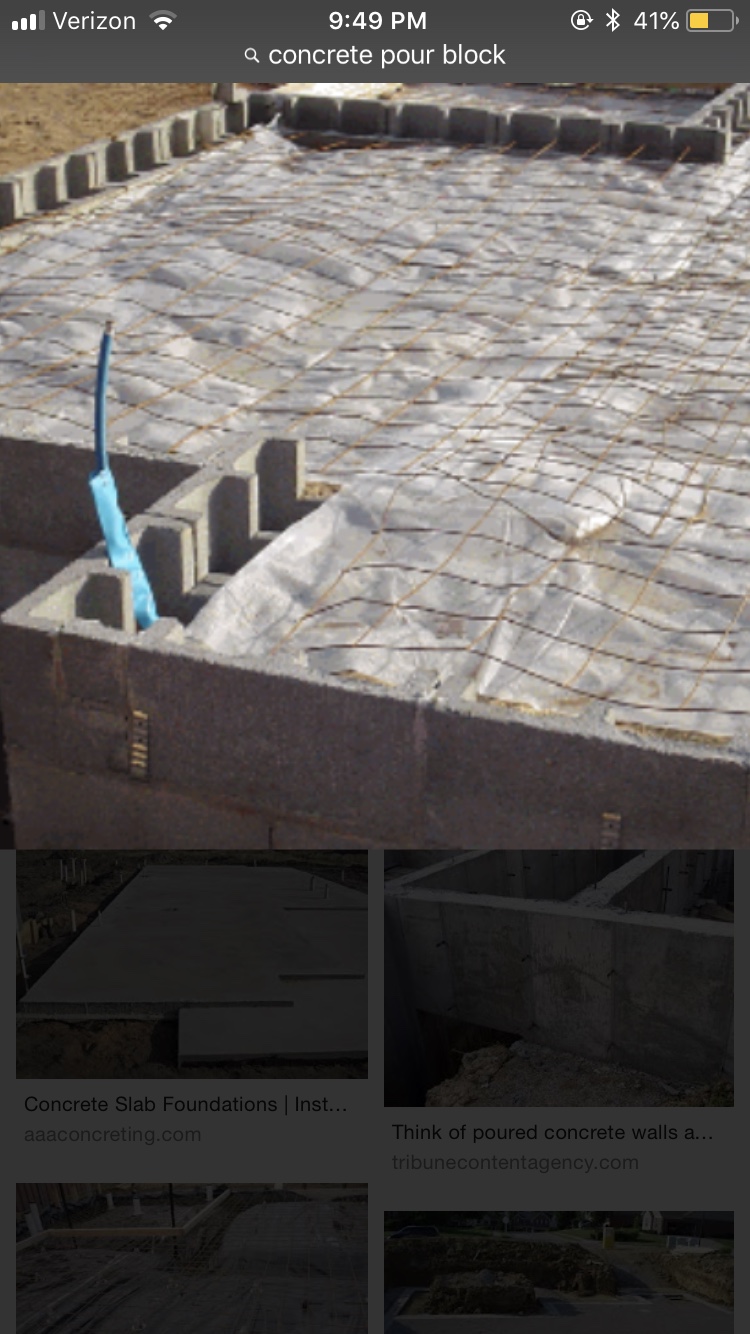

Would you touch this with a 10 foot pole? Wood floor in a job that IMO should be conc
Earth moves with the seasons, and things in the earth move with the earth. A deck needs to be either so firmly tied to the house that they can only move together, or completely free so that they can move separately. There is no middle ground. The damage that deck has done is exhibit A as to why there is no middle ground. It's obviously not free but it's moving enough to damage the house. Unless you can find a way to tie it to the house it's not salvageable -- and I can't think of one. I suspect that even if the deck had been properly supported it would have had the same issue.
So assume that the deck has to come off and start there.
It’s not a deck. It’s a poured concrete porch. It’s poured inside of a concrete wall that has brick on the outside of the wall. If they had of cut the blocks like this they probably would have been fine, but they didn’t. It’s poured inside of a straight wall and it’s slipping deeper inside. See post 3 for the picture of the underside of the slab.

He knows we can’t salvage slab and is good with taking it out. A 3rd party company might could salvage it, but not cost effectively. He doesn’t like the current stamped concrete slab anyway. I don’t know why. That’s about as durable and low maintenance as it gets. It’s possible to make the wood structure hood up but I feel pretty certain he’s going to neglect the necessary steps to do that. He’s known water was a problem and done nothing to handle it for years. The last picture I posted in the first post really doesn’t do the water problem just. Quite a bit of water runs across the back of the house there. That ditch is close to a foot deep from erosion. Left untreated it would eventually erode the base of the foundation and cause serious issues. He doesn’t seem concerned.
