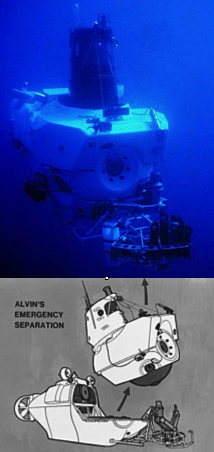

I don't know what I'm talking about, but help think the Alvin is one submersible that set the gold standard for deep see exploration, and it really doesn't look like a sphere to me.
Alvin only held 3 people.
Then took another look. Deepsea Challenger, which I believe holds the record for the deepest dive to 36,000' under water. The only downside? Only holds one person.

The Alvin uses a sphere for the personnel compartment. It was upgraded to titanium in 1973. The Evolution of Alvin
4,700 deep sea dives in 50 years.

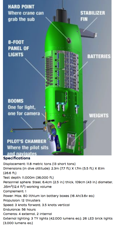

The Deepsea Challenger also uses a steel 2.5" thick 43" sphere for the pilot compartment. DEEPSEA CHALLENGER Pilot Sphere

The key word "compartment".
As I noted, it makes sense due to the pressures you're dealing with that a sphere for a compartment makes sense, but can we both at least agree that a sphere does not make the entire vessel to explore? If the entire vessel were only a sphere, I would imagine it impossible to navigate the structure where you want it to go.
A sphere could be designed with a propulsion system making it 360 degree manuverable.
The bigger issue is why not use a robotic system given the advances in robotic controls and camera systems?
Would you voluntarily stuff yourself into the Deepsea Challenger's 43" sphere for hours on end?
