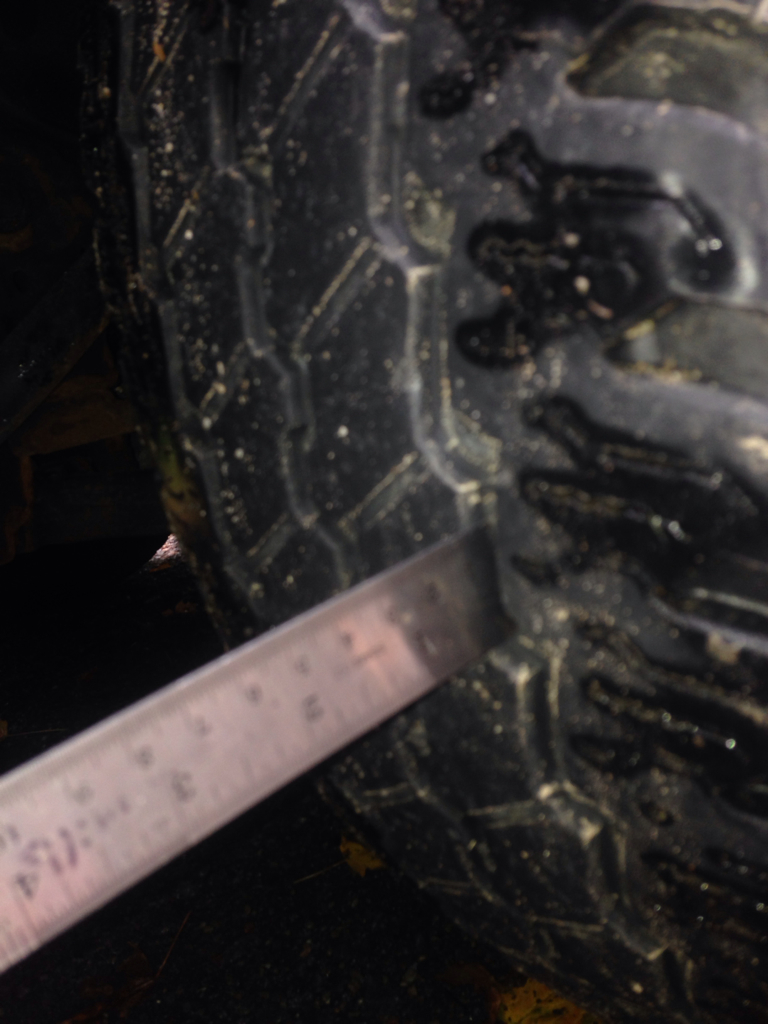

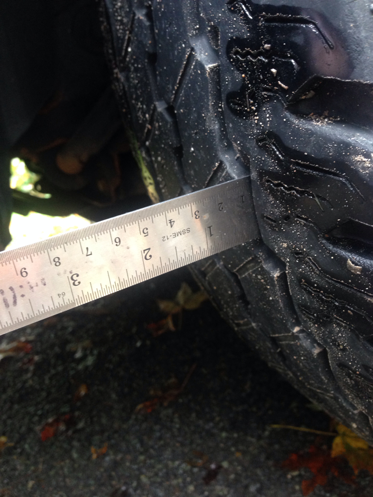

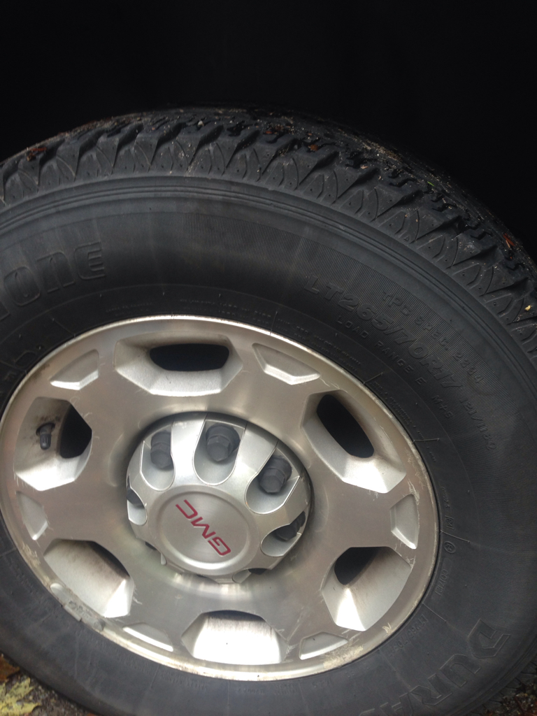

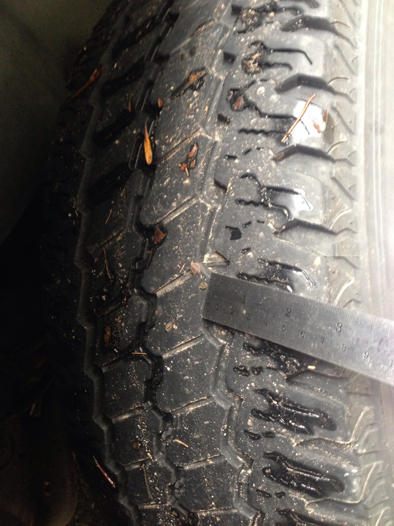

Sure enough, 107,000 mi on Bridgestone Duravis commercial tires. I do rotate tires with each oil change. My Sierra 2500 diesel is my daily driver, and easily 90-95 percent of mileage has been and continues to by highway, occasionally towing but rarely loaded with more than 500-600 lbs.
I was so happy with the Duravis mileage, that I held out for exact replacements despite the tires having been unavailable/ on back order for a couple of months despite needing them badly. No belts visible but with very little tread left when replaced. Replaced just in time for the coming fall season two years ago, 50,000 miles ago!
As you can see, have lost only the most superficial water sipping grooves on large lugs. Pricey at over $1300 for a full set, but with my current set duplicating my previous wear rate, I reccomend them highly!
