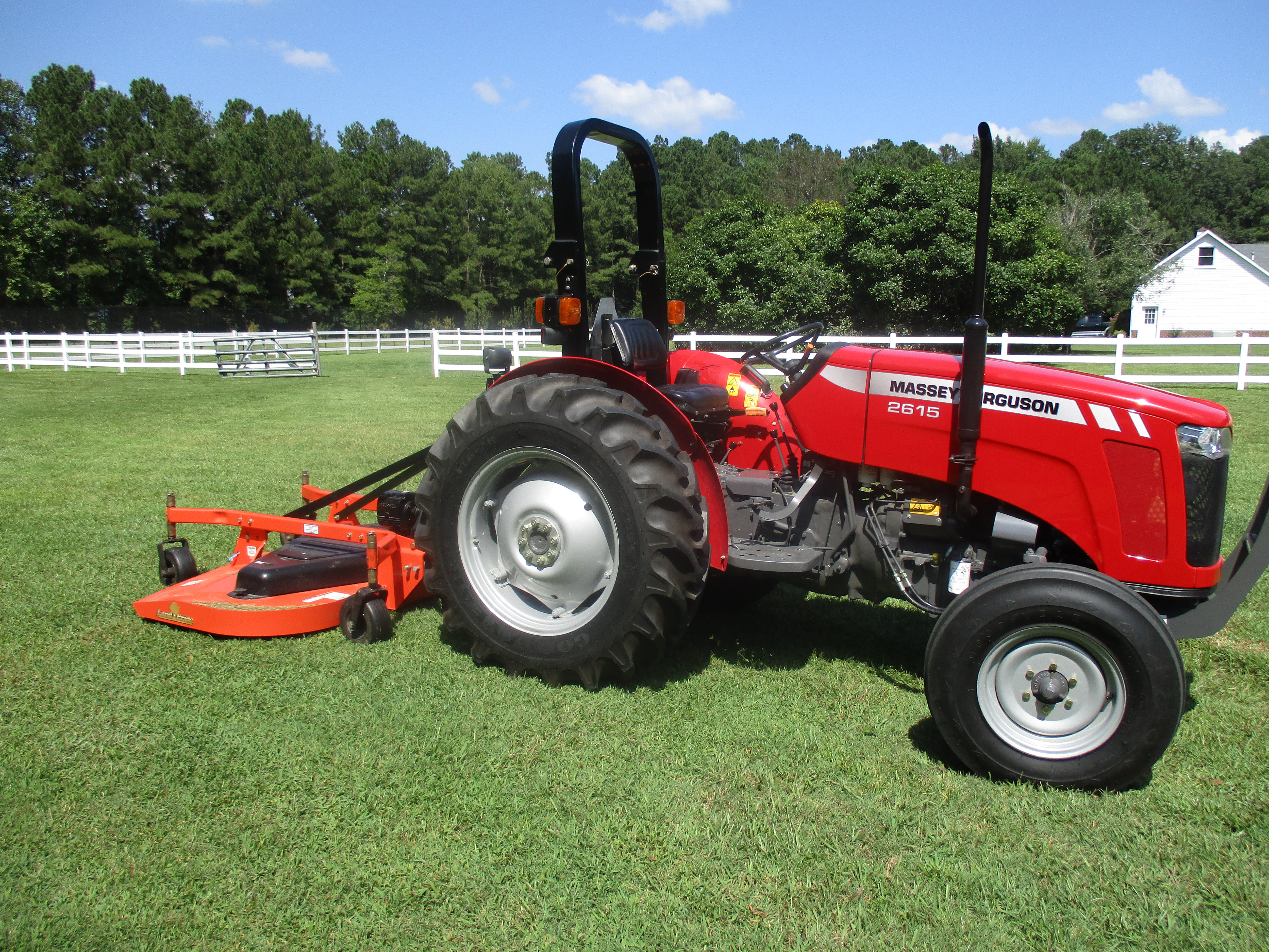

With a new 1100 pound Land Pride DH25 disc harrow on order, coming in this Friday, I'm considering adding a little more tire to my Massey. I did this before with a small CIH Mitsubishi powered tractor and the larger rear tires worked out exceptionally well. I'm retired and just doing this for fun; helping a neighboring older farmer with his fields. Mostly sandy with some clay.
If you look at my tractor in this picture, this is a 50hp 4300 pound tractor that looks like it could use some more tire in the rear. I've ordered 600 pounds of weights for the front,
but those oem rear tires look like they were bought for lower cost versus highest traction. I never drive fast btw.
So...can I go up a size, say wider an inch and higher one inch, I eyeballed the tractor carefully, definitely have enough clearance.
The real question is, what will one inch get me? That's two inches more grip.
I'm sure something but is it worth it on a tractor with less than 200 hours on it? Meaning these tires are like new, but I'm trying to pull
a heavy disc and when I dragged it with this tractor last year granted in muddy condition, I had a heck of time with traction. My Kubota in 4wd just walked away with the disc, but less wet.
But I want to use this Massey to pull the new disc, it's a real "farm" tractor and tough as nails, Indian with a Perkins design engine.
But I think it's traction limited now.
I'm a tire guy, study Tirerack intensely, and have looked at the Michelin and other primo websites. My their tires are expensive...
but I don't need tires for the Autobahn.
I'd like this Massey set up for field work and woods work and the Kubota left for FEL, chipper and other implement uses.
The front triribs on the Massey are great, nice big tires, very comfortable ride on this tractor.
Last time I bought tires I bought BKT for the rears. Massive rugged tread, Indian tires, probably appropriate for this tractor too.
I'm not worried about the rear axle either, it's pretty big, bigger than the Kubota's...
Who has tried going bigger and has it helped? Hints?

Are you existing rear tires LIQUID FILLED? Filling is the most cost effective method to increase tire traction.
Are cast iron, bolt-on rear wheel weights available for your tractor? That is the second most cost effective method to increase tire traction. You can sell wheel weights if you decide they are not necessary.
Most of your forward pulling power is provided by the large circumference rear wheels. That is why 2-WD (only) tractors are always rear wheel drive, never front wheel (only) drive.
Some (not I) have cautioned here that filling or weighting FRONT wheels/tires is tough on power steering, tough on 4-WD and tough on front axle if a loader is used.
((Or have you ordered rack weights for the front of the tractor, rather than the wheels?))

Are you existing tires LIQUID FILLED? That is the most cost effective method to increase tire traction.
Are cast iron, bolt-on wheel weights available for your tractor? That is the second most cost effective method to increase tire traction. You can sell wheel weights if you decide they are not necessary.
thanks. Good question, no. Am exploring rear wheel weights now. I have both on the Kubota, it was pretty light in the rear, or felt that way.

If your existing tire is a 13.6-28;
a 14.9-28 isn't much upsizing,
a 16.9-28 is a good increase, then there is an 16.9-30 would be a nice increase,
then 18.4-30 which would be a major step up.
My IH 574 was original spec'ed to have a 14.9-28 and she currently rides on 18.4-30's
It has a bit more HP though.

Good question. No, tires are not filled. Am exploring rear wheel weights now.
When I run the Kubota in high gear on the road I seem to get a lot of shimmy, darting around, tire pressure is ok, always wondered if that liquid filler was sloshing around and creating imbalance. Massey was straight and true and stable as could be on the road.
Filling rear tires 3/4 increases tractor stability. Wheel weights do not.
When tires are spining centrifugal force, in theory, should space liquid evenly around tire. Instability comes as you attempt to slow down, especially if you attempt to turn while slowing down.
"When I run the Kubota in high gear on the road I seem to get a lot of shimmy, darting around."
I speculate your rear tires may be 100% full, rather than 75% full. If tires are 100% full you do not have pneumatic suspension any longer.
R1/ag tires are always a comparatively rough ride relative to R4/industrial tires at speed on hard surface roads.

I definitely agree with those who recommend filled rear tires to increase traction. Bigger tires will increase flotation and to a certain degree traction. Fluid filled rear tires will provide measurable increases in traction. You are not looking for flotation - you want to get maximum pounds to the ground. If you are looking for best bang for your $$ - fluid filled is the way to go.
/ Would larger tires help? #15
Another vote to fill rears.
But even then....if your kubota "walked away" with a heavy disc....when the conditions were actually proper for discing then I'd have to think that a 4300# 2wd should be able to do the same if you keep it out of the mud. That is assuming the "heavy disc" you pulled last year is similar to the one you have ordered?
Going up in tire size...I dont think is going to make a bit of noticeable difference.
Fill tires, then wheel weights....in that order.

Sure those tires probably offer better traction because 20% deeper lugs when new. But what's the game plan? Change them after 30% wear? You aren't always gonna be pull with a 100% tire
As to wider....14.9 is about a 10% increase.
But keep in mind that ground pressure is equally important as contact width. So you loose 10% ground pressure.
Adding weight increases traction because you are increasing ground pressure. The lugs have to be able to penetrate to bite. And if on loose (already plowed or disced ground) the tires have to be able to somewhat firm up the ground under them to bite.
So it's a trace off.
