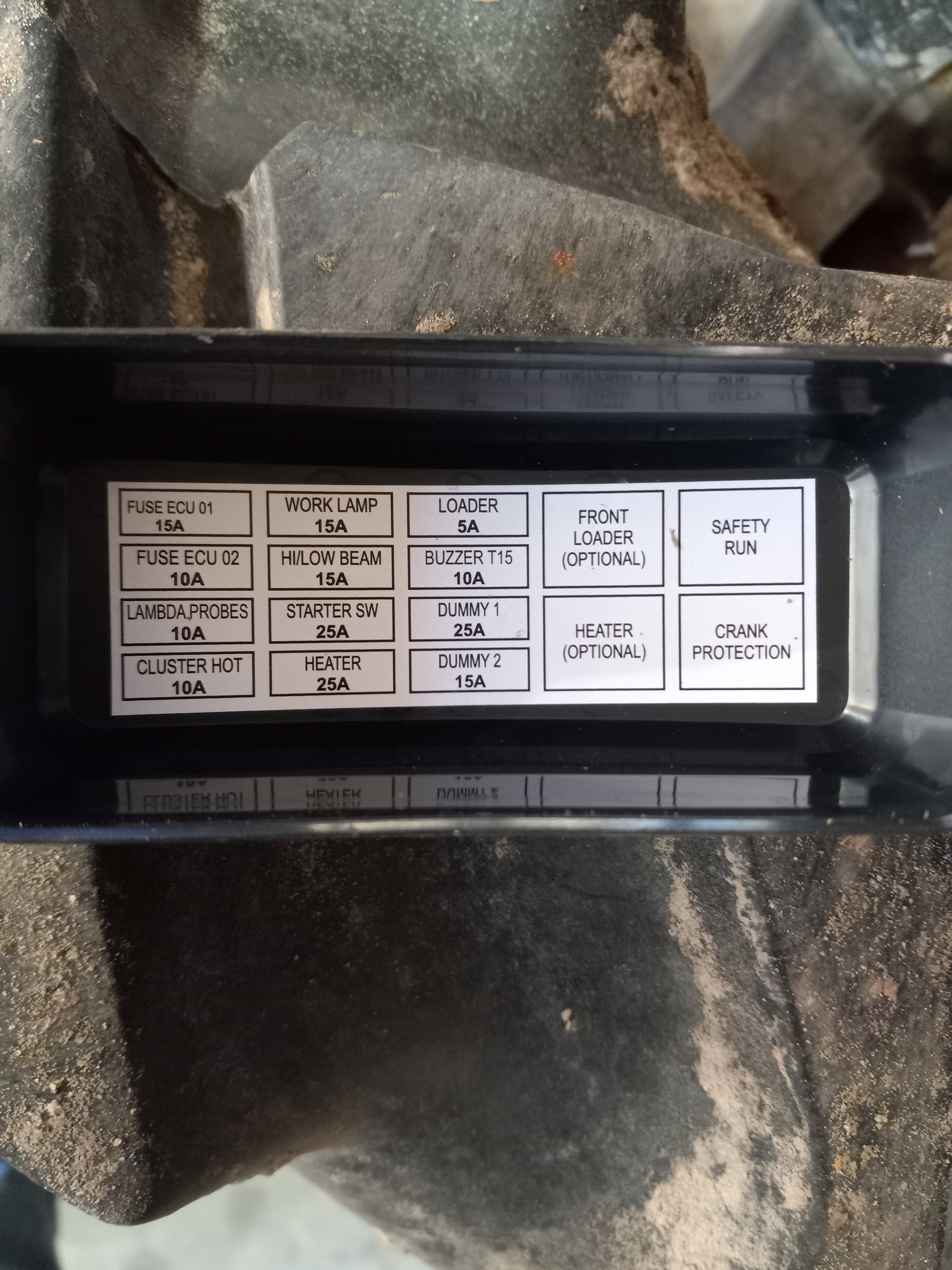

Hello,
In the event you don't receive an answer from the poster..
Left front of machine are 2 relay/fuse boxes. Box closest to the seat (back of machine and has fuses in top half ) has a relay labeled "Safety Run" (bottom right- see attached pics).
/ Workmaster 60 dies in neutral #15
Thanks that fixed it. 5th factory relay I have had to change in the last 2 years. At this point I may swap them all out.
