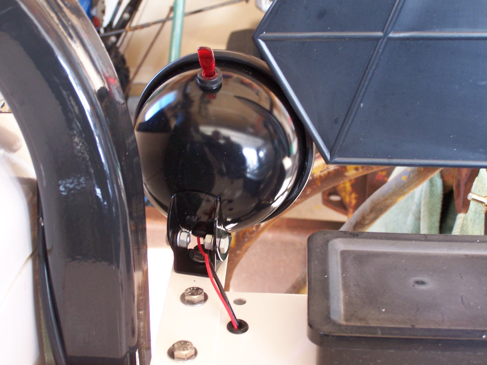

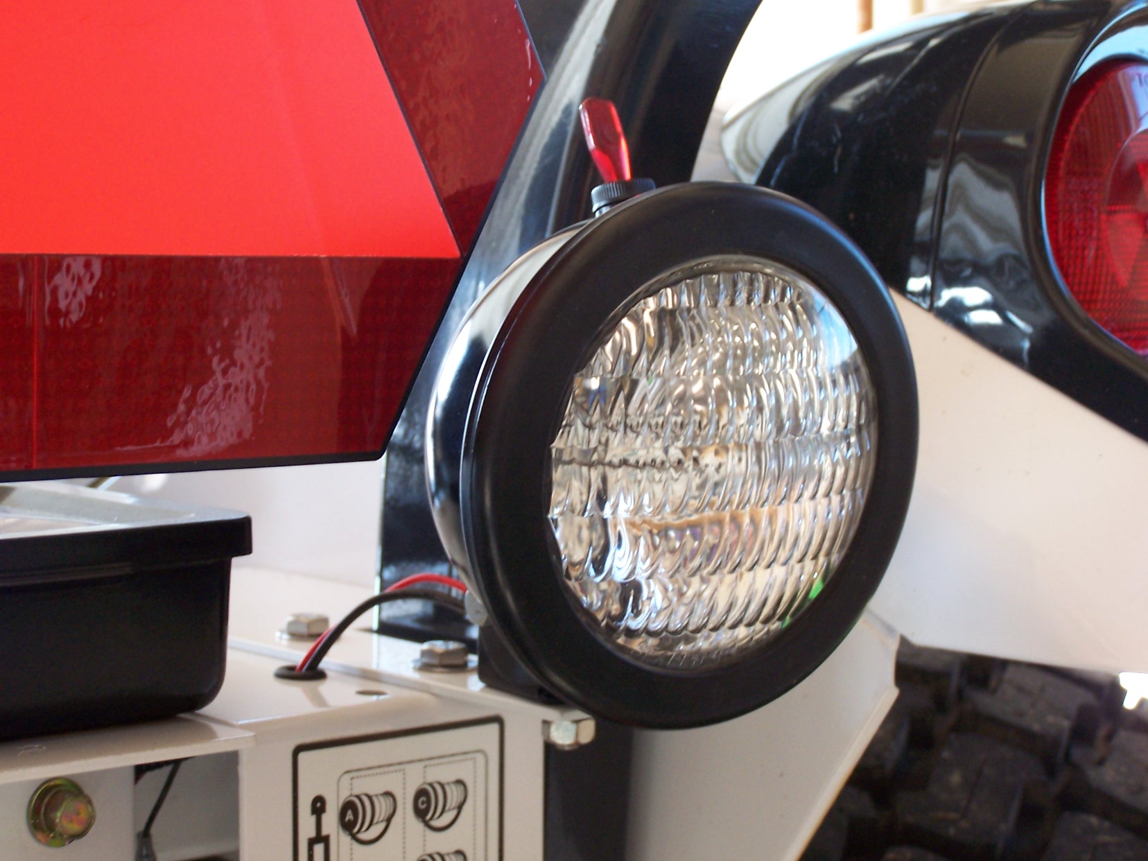

I just installed my work light. I purchased mine from TSC for $14.99 plus a switch for $3.50. I bought the heavy duty 65W light and drilled and mounted the toggle switch to the light. Total cost was $20 and it was a real easy install. Even the drilling and wiring of the switch was easy. If you're somewhat handy go this route and save the money. I'll post PICs later.

Yes, I did tap into the existing wires that is supplied in the rear of the tractor. I was going to install the switch on the dash but realized this was overkill. I placed the switch onto the housing of the light and when I need it I will flip the switch of the light. I'll post PICs later this week.

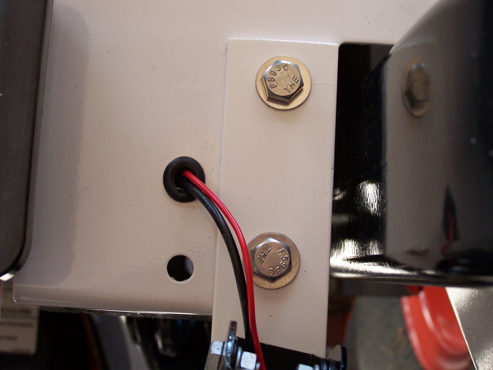

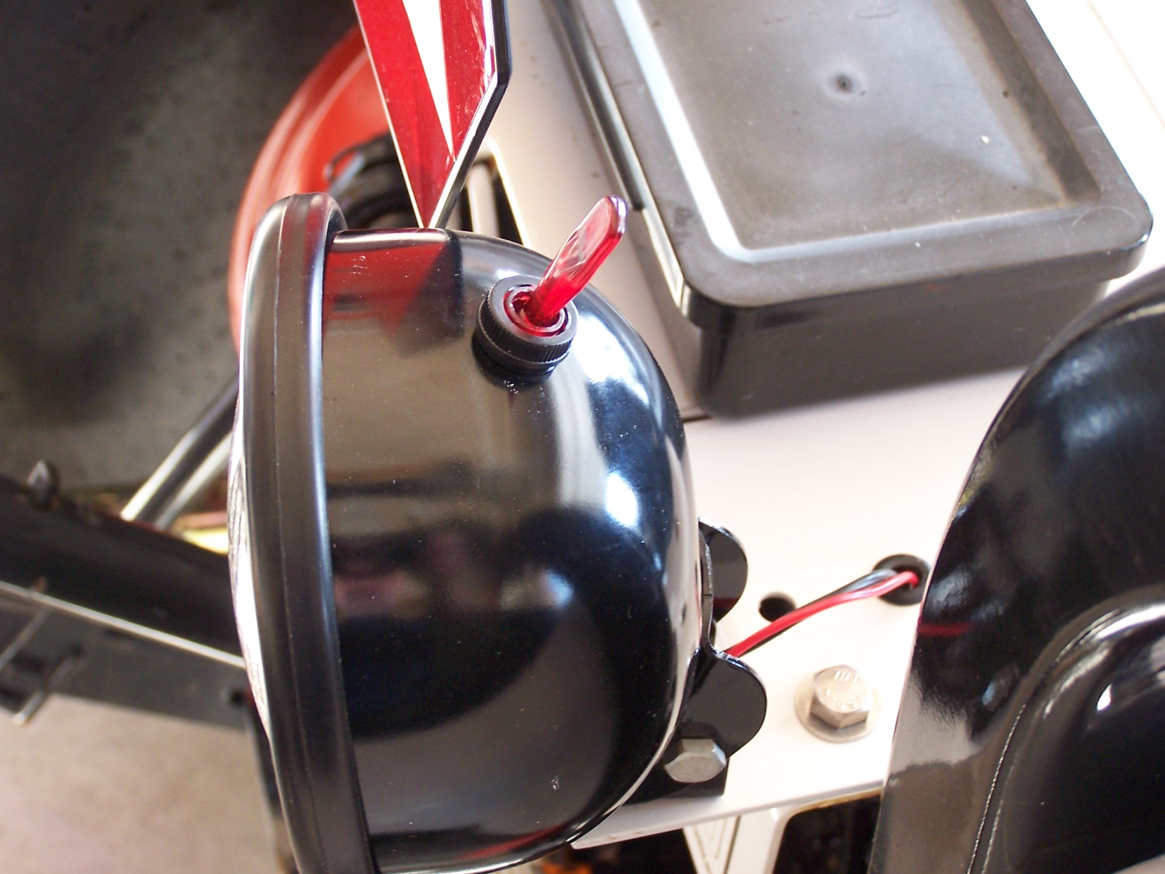

Here's the PICs of my worklight install. I decided to use a bracket because if I installed the light to the existing hole it would interfere with the SMV sign.
Doug
