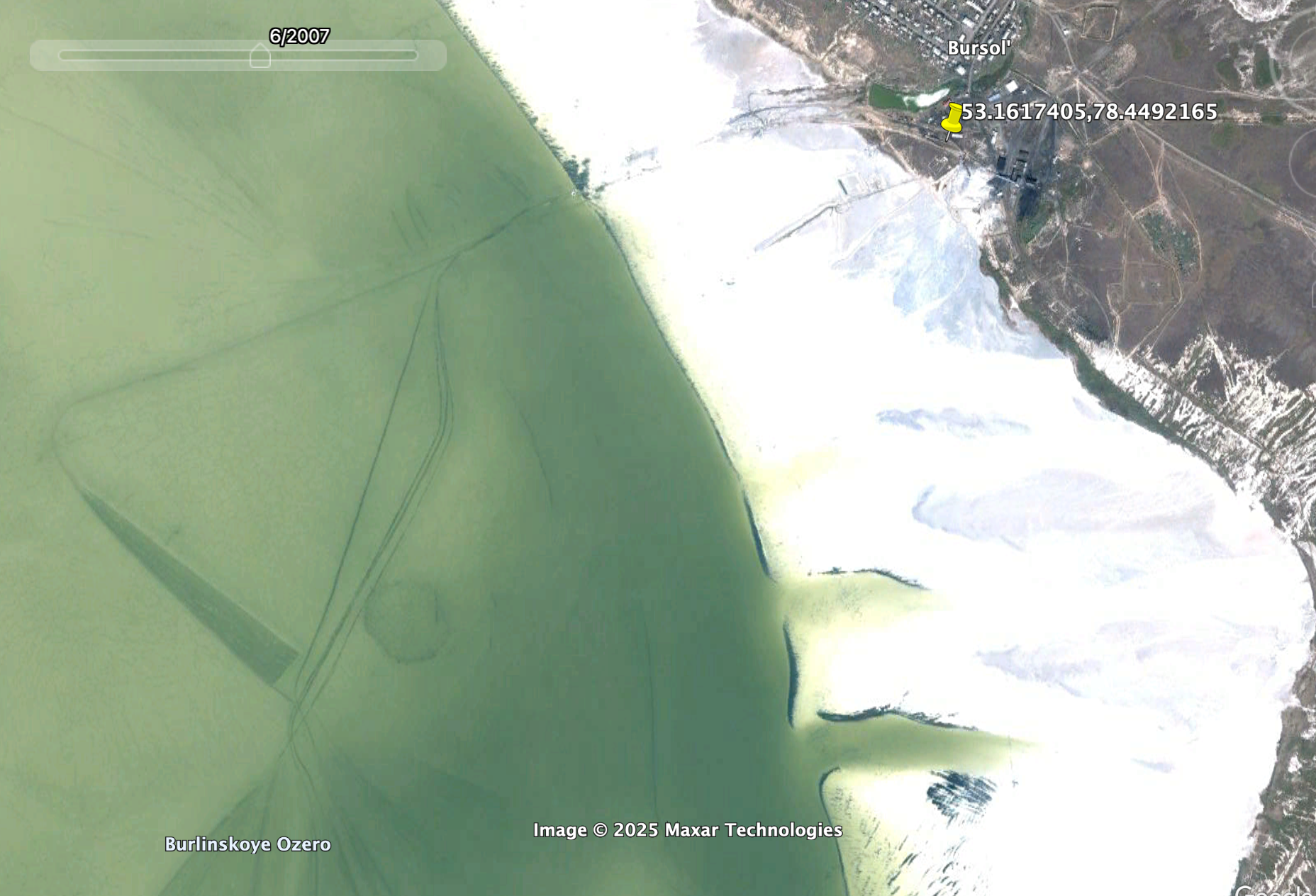

Aerial view
Using the Google Earth app and looking at the 2007 photo, you can see a network of underwater tracks or older and newer ones.
