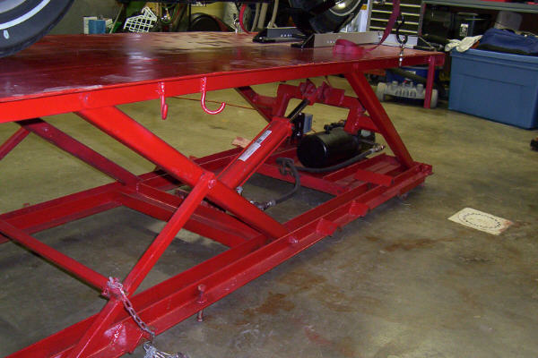

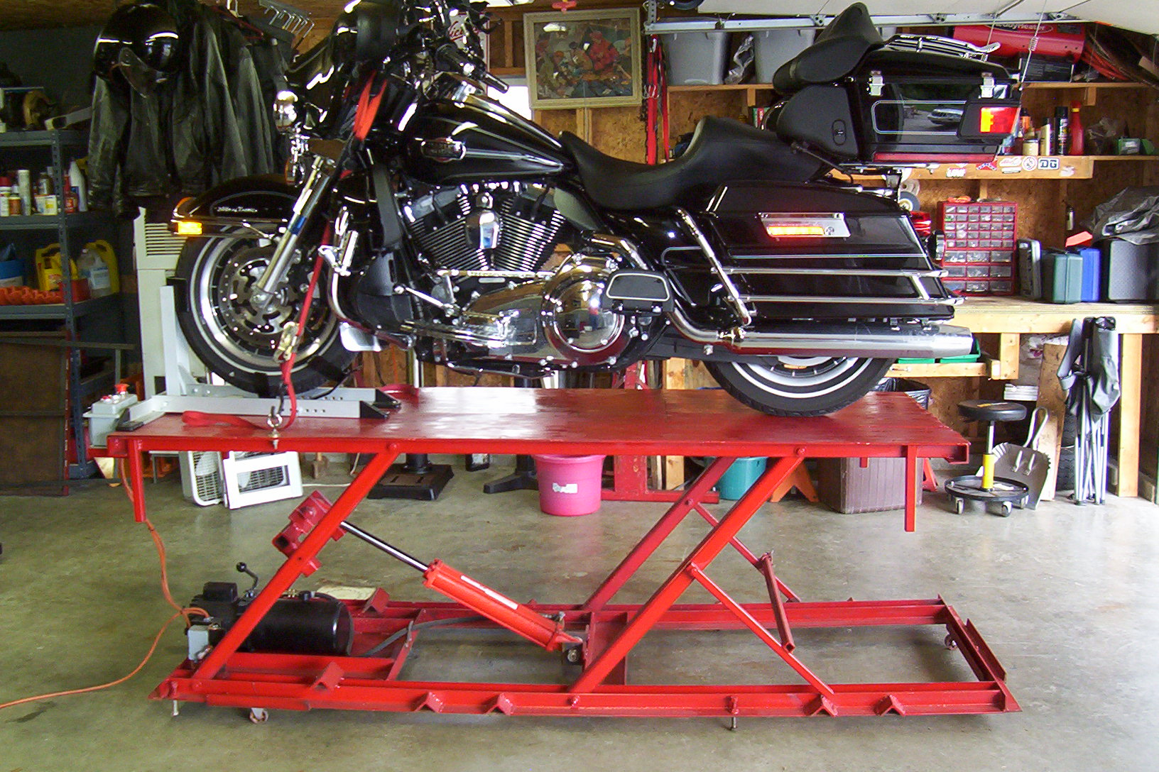

Here's my work bench. I built it from 2x2x1/4" angle. I bought the hydraulic package on ebay along with the motor starter and switches. Its a lift for my Harley and doubles as a welding / work bench. I have a 6" vice mounted on it most of the time. The adjustable height is really handy depending on what you are working on.
