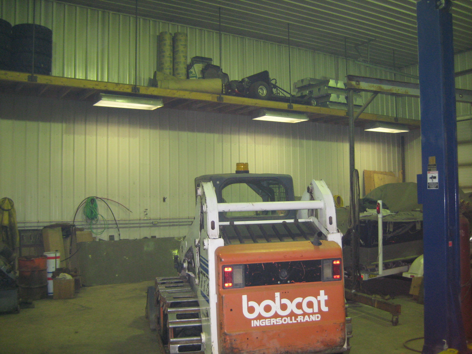

Mine is 4 by 6 and about 4 ft tall. Was made to slide on and off my pallet forks and can be secured with a pin.
I set pallets of item on it then pick it up with the pallet forks to reach the 12" balcony in the shop. But it has also proved very handy for tree pruning, building construction, servicing lights at the 18 ft ceiling.
I'll take my chances with the hydraulics over a ladder any day. Myself and 200 or 300 lbs of tool on the platform does not equate to much pressure in the hydraulic system. The odds of blowing a hose are minute.
