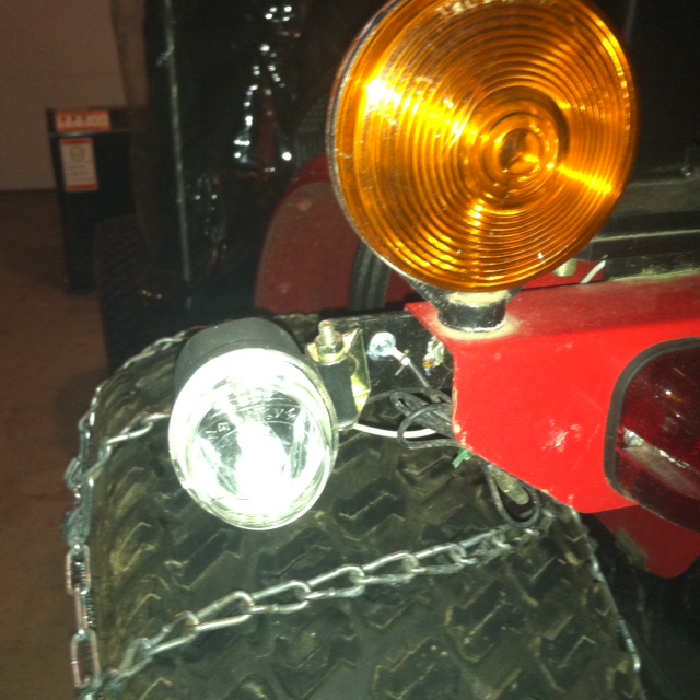

I took a 1 1/2 x 4" piece of metal and drilled a hole for the light, attached the wire and used a tec screw to ground it and mounted the light right around the bracket for the turn signal. I'll take a picture of it this evening if you like. It took me all of ten minutes to wire and mount the light since the wire already had a male barbed end on it. I didn't cut any wires, I just tied them up tight with a zip tie.

I was looking at Dave's photo. There is a hole I used right below the light on the red bracket, so there was no drilling in the factory metal just as an FYI.

The lights in front were mounted to the bracket because I have a soft cab and if I had put the lights behind my eye level I wouldn't be able to see due to the reflection ( i tried it), so I mounted them with my home made bracket. The lights in the back give me more than enough visibility. They were a cheap set of small fog lights from Wally World. I think I paid 15 bucks for them and threw the switch out. I think I will change them out for some LED's like I have on the front since they draw so little power and are very bright. In the Summer, when I use the tractor during the day I unplug the rear lights, but all my snow clearing is at night in the winter so I keep it plugged in.

Rear lights, no switch, front lights no switch either. I tapped into the headlights for the fronmt because the LED lights draw so little power and I didn't want another switch cluttering my dash. For the front I did have to drill a very small hole in the gray plastic beside the headlights on the laft side. It is all very tidy. Of course I also sheathed all my wires so there is no chafing.

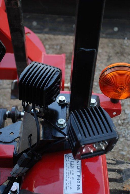

I have sent DavesTractor a PM about this, but figured it a good time to drop my first post.
I'm drooling over those ROPS light brackets Dave has pictured. I did just fine with the lighting that comes stock on my Max, but i can see where more would be beneficial... especially out the back. I'm not much for fabrication or welding... so making something like this myself just isn't an option right now. Wondered if anyone knows where i can score a pair of these beauties.
Dave, in the pic you posted showing the difference in lighting (stock vs w the rigid lights). Am i correct in thinking you have 2 spots pointing forward, and one flood pointing back... or is it 2x2? Those images show quite a difference.
Lastly, anyone ever try magnetic lighting up on the ROPS? I know they make some with beastly magnets, but wonder how they'd fair with the vibration.
Thanks in advance guys....
-J
We burn the brackets on our plasma table as needed. We include them at no charge when you buy at least a pair of Rigid lights at normal price. In the pictures we showed, we had two Rigid Dually Floods going forward and a pair of Diffused going back. Each pair on it's own switch. The only problem with Rigid lights is the initial purchase, they are expensive. They do not try to compete with the Chinese import stuff. It may be that some of the import stuff is great, I really do not know...we just started with Rigid and like them. But I think they are sort of like the Snap-On of lights. We have never had even one problem with them. I have them on about everything I own.
You could just buy brackets and spend less on lights for sure. Even if they work only half as well, it will still be a lot of light. I'll email you some pricing since my goal on TBN is to be helpful and to learn from others, not to sell stuff. It's best we do not do any pricing on the forum I think.
Thanks for the kind words on our brackets. My son is handy with the plasma table, he designs and builds this stuff.

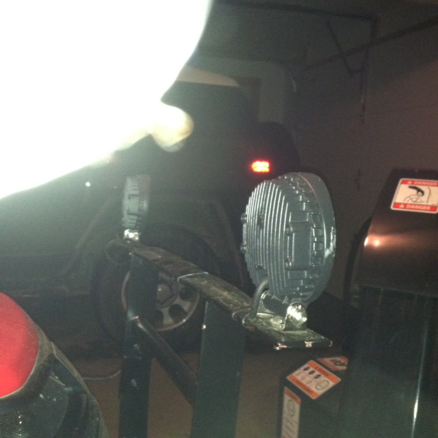

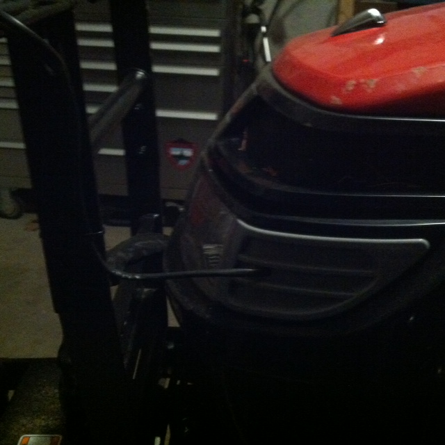

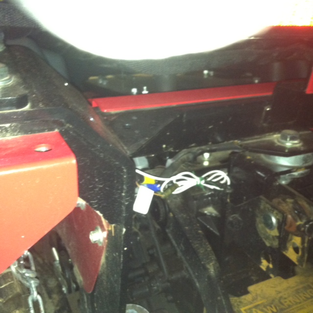

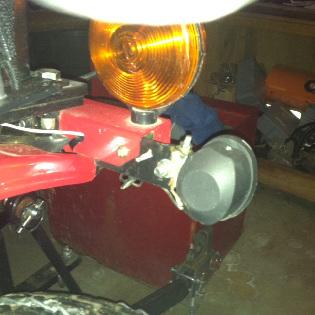

Here are some pics of my light set up. light.jpglight2.jpglight3.jpglight4.jpglight5.jpg The first is where I ran the wires to the main light harness. The second is just the back of the front lights. #3 is the back of the light bracket I made 4 is facing the rear of the tractor and the last is where the wiring is already existing below and behind the seat on top of the PTO.

My daughter lives in West Greenwich just off 102. You probably got yours from Dubays as I did mine. Unfortunately,.I did put a work light on the rear but only after I changed out the bulb to a 35 watter instead of the 55 ( halogen) that was in there. Wire coming out the rear was only 3 amps. Enough for an L.E.D. but not a halogen. Just couldn't fathom spending a hundred bucks for a rear work light,

K88, Thanks for the pics. That front light bar looks like a beast, and well put together. The wire thru the side of the engine case looks alot cleaner than i had expected. The only concern i have with your rear facing set up is the lights look to be a little exposed. I work in alot of tight brush and woods, I'd fear something catching on it and removing it for me. W that said, i'm still leaning toward picking up a set of the brackets from Dave... just not sure the wife loves the idea of 400$ for work lights... so i'll likely just snag the brackets for now, and figure out which lights once I get them.

Th rear lights are on a swivel so if they get bumped they do bend inwards. That was a concern, but thus far has not been an issue.I sealed the hole inside the engine compartment with a dab of hot glue for the front lights. No real reason since it is sheathed, but I wanted it neat.

Never even considered a "break away" design for those rear lights. Good thinking.
