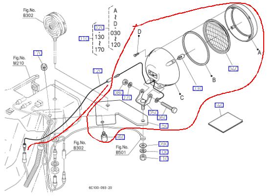

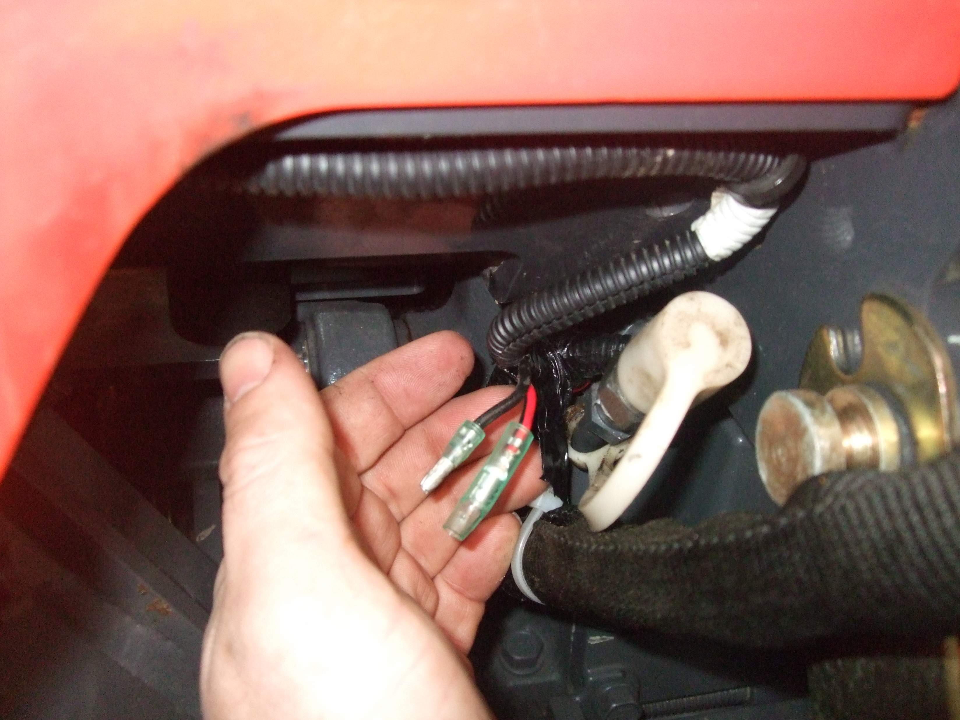

Just bought a work light kit from BxExpanded. Does anyone know where the electrical connectors are located for an aux work light on the BX25? The fuse panel contains a 20 amp fuse for a work light, but I cannot locate the electrical connectors. I tried pplugging the work light into the rear tail light, but blew the 15 amp fuse - so no go on that.

how did you plug it in the rear tail light ? there is a switched pigtail in the back of the BX. follow the taillight wireloom towards the middle of tractor until it reaches the Y part. there is a crimped connectors under black electrical tape.

Thanks. Guess I never thought to unravel the electrical tape. I'll have a look tonight. Do you happen to know the amps of the circuit available? If not, I'll test w/ a Multi.
BTW, I found out the hard way that the fuel pump and headlights are on the same circuit.... :(

Since the Light Kit is designed to fit almost any tractor, large, small, red, blue, green or orange, we have a bit of problem with describing or picturing the location of the connectors. Almost all late model tractors have a connection for worklights somewhere at the rear but the location is different on the various models. The BX connection for instance, is at the rear center. One of the Bs is near the right tail light.
We'll try to find some way to provide the appropriate information in the future.

The wire connections is right under the electrical tape at the y part. locate your tailight wires and backtrack it to where it meets into a Y. Within the Y part is a folded up wires under tape.
The wires is switched on from key on so no worries about leaving lights on.
