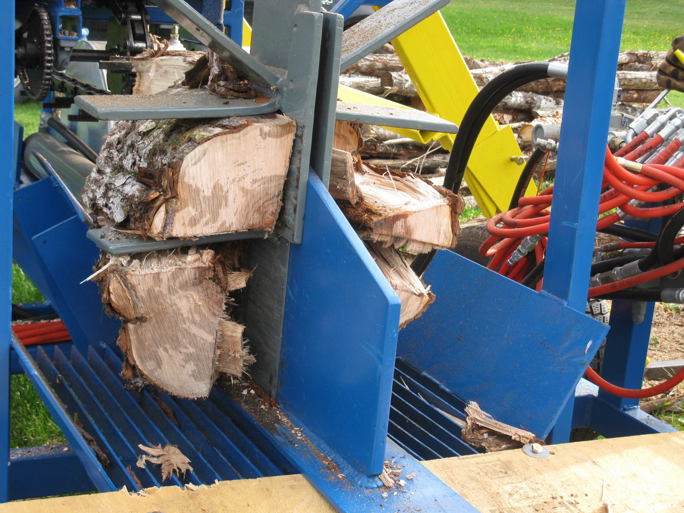

The processor we made has a 16 inch cross blade, (we removed the 6 way blade, never used it and it was in the way all the time) we are not working around it so it isn't a problem. If you are working near it you may want it a little smaller Just remember to weld it behind the main splitter blade, this will allow the wood to start breaking before you split it the second time, this requires less power to break it. Jim

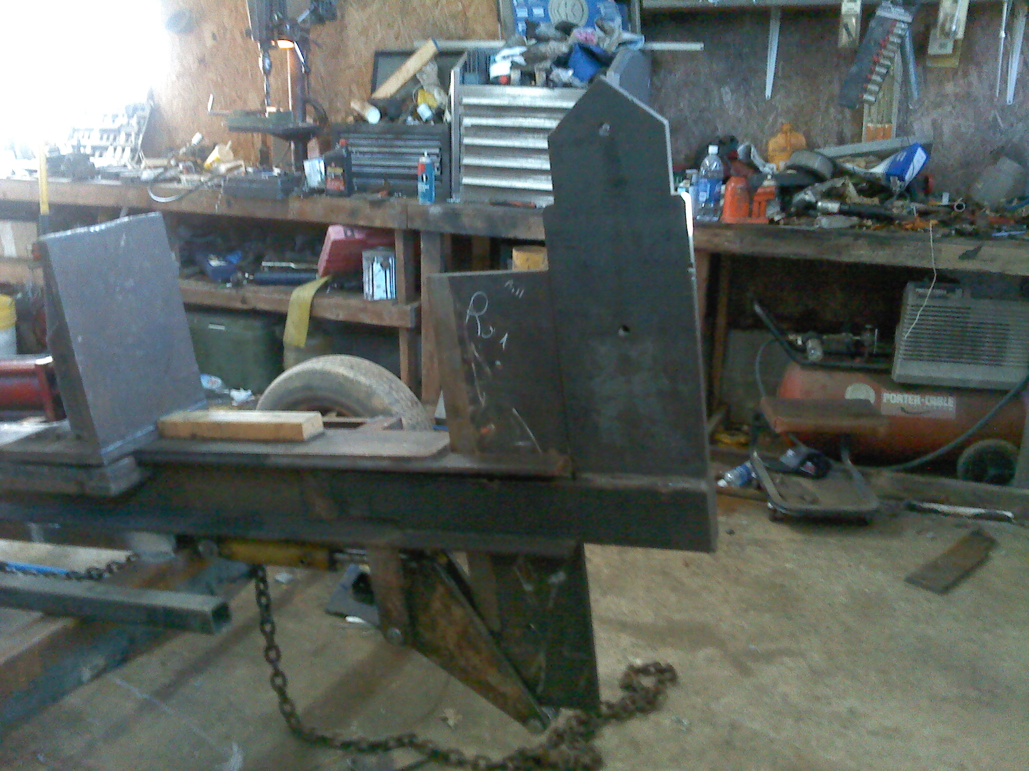

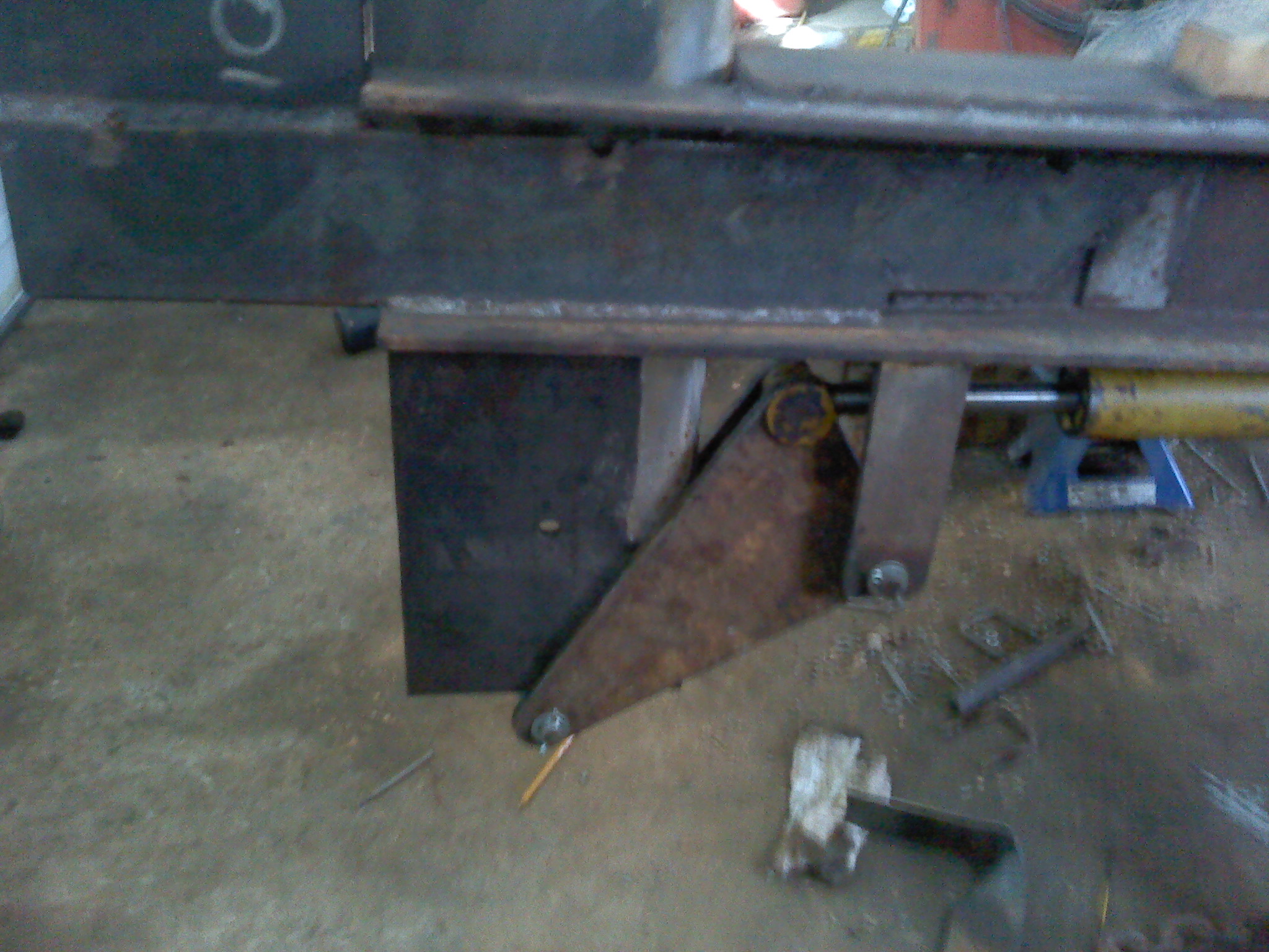

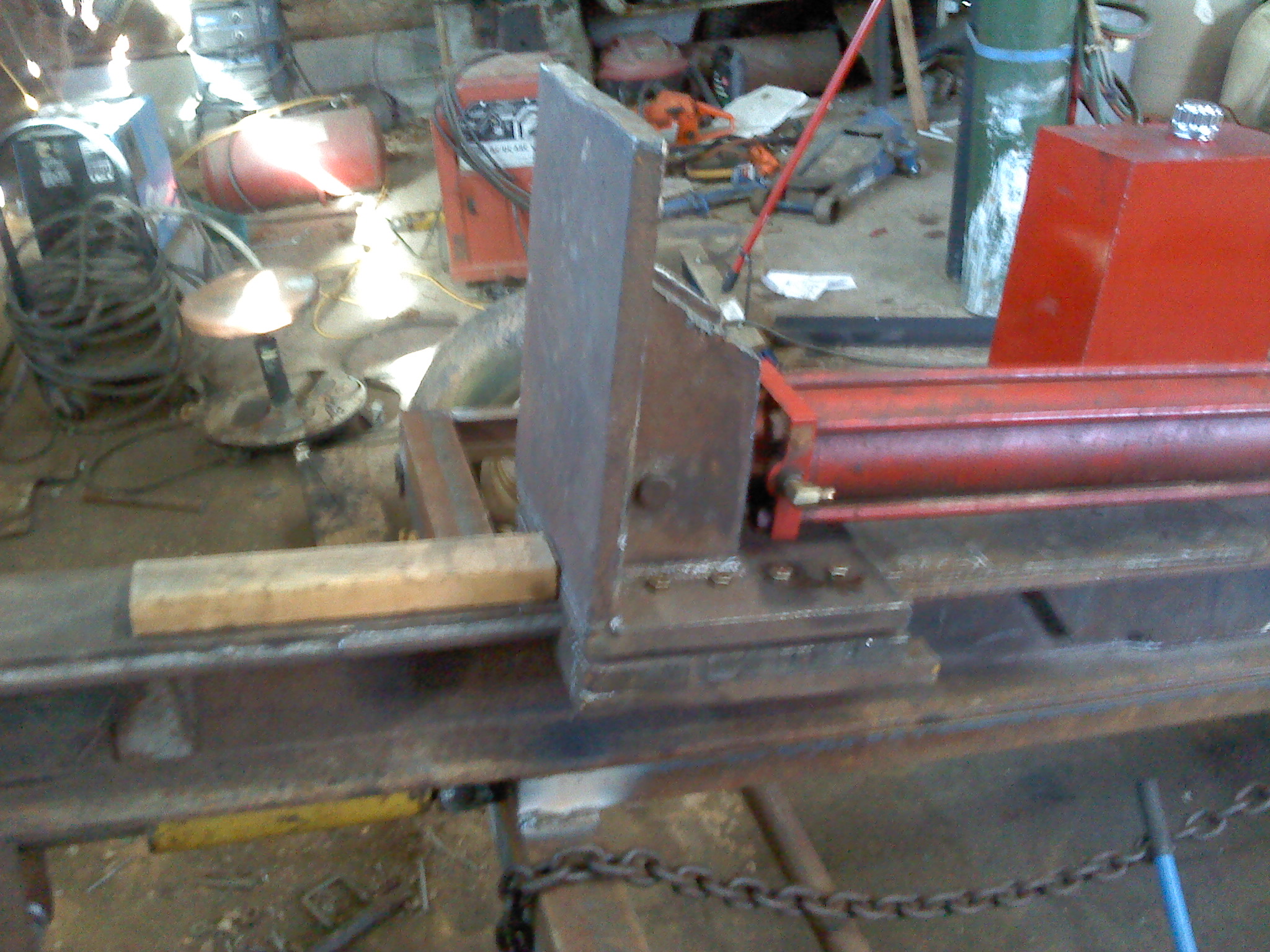

Here are a few pics of my project. The wedge and back bone are 3/4X9in T1. The hbeam is 6x6x1/2. I have reenforced the web by adding some of the 3/4 t1 to each side. The top flange has also been reenforced using 1/2in plate. The slide is all 1inch plate. The lift clyinder is 2 1/2bore x 6in stroke. The lift arm has a sealed roller bearing that contacts the blade so it just rolls across the bottom of the blade as it raises and lowers. I am planning adding some 6inch channle on each side of the hbeam where the blade slide up and down. I think the channel along with the 1 1/2 inches of extra webbing I have already added, should help prevent most of the hbeam flexing.

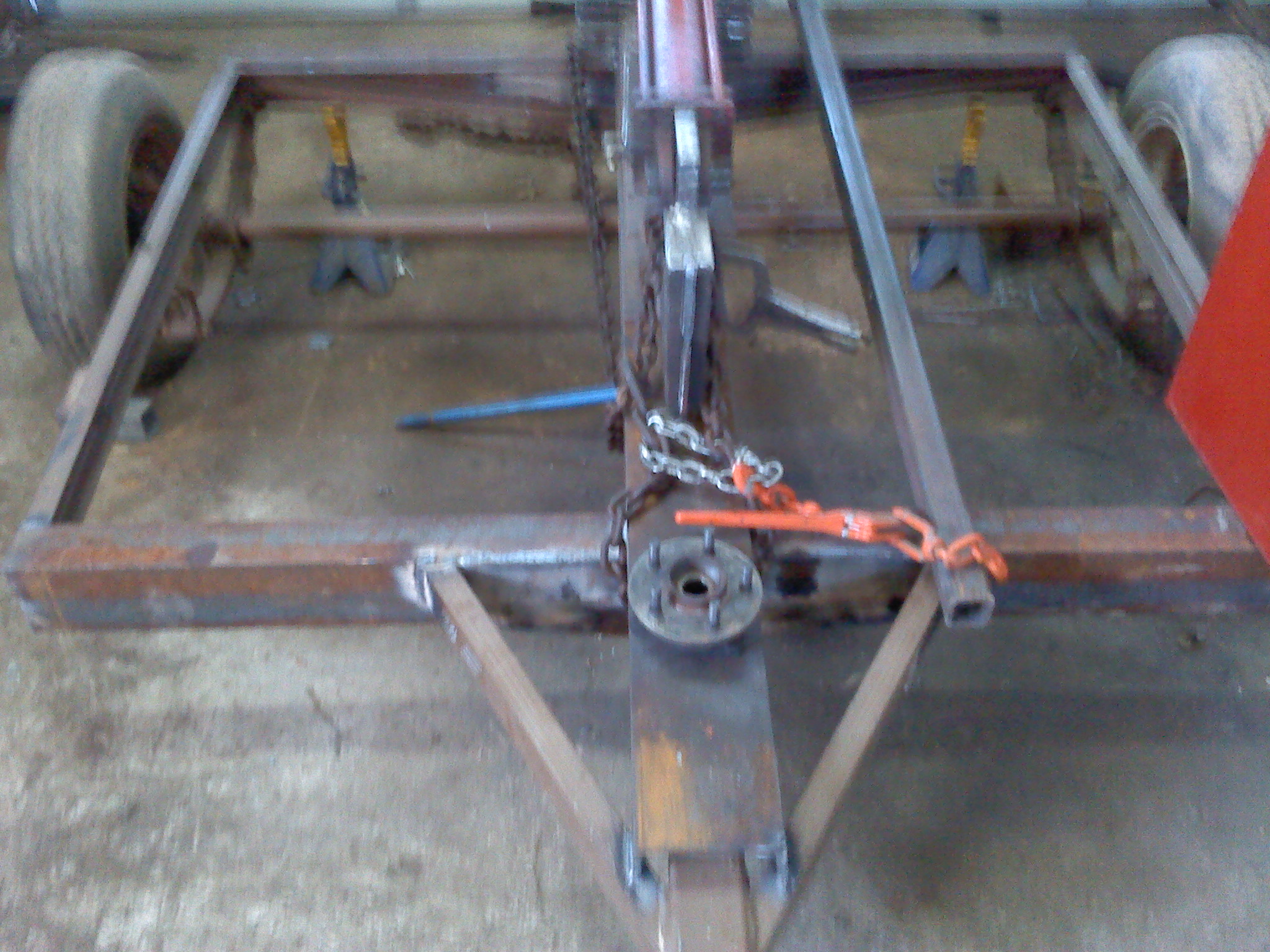

The trailer is a old boat trailer I cut to lenght. I put the tounge on the opposite end of the splitter wedge so I could just pull the splitter up when the wood gets piled up while being split. If you look close on the tounge portion of the trailer you will see a front hub off a junkyard front wheel drive car. The hub actually unbolts from the car spindle and I am just going to bolt it on the 6in channel under the hbeam. I intend to bulid a small hoist to mount on the hub to make it easier to lift those extra large rounds onto the splitter.
The cylinder is a 4x4 chief from nothern hydraulics, I bought this cylinder probably 20 years ago to build a splitter with and am just now getting around to it. It will be powered by a 25hp kholer I already had laying around and a 11gpm vickers vane pump. Motor is overkill, but later on as funds permit, I will be replaceing the pump with a 28gpm 2stage and a 5inch cylinder. I also have a knuckle boom loader onthe drawing board so the power will come in handy later on.

Looks good! I think it will work well.
I misunderstood your first post, I thought that you were placing the tall wedge on the end of the cylinder so that the wedge would slide along the beam.

My vertical wedge is 3/4 thick. I will have to add some rails on the back, to keep it aligned with the backbone, which will act sort of as a spreader as the wood slides toward the back of the wedge. I agree with you on the horizonal wedge. I intend to only sharpen the top edge of the wedge so the bottom half of the log is not forced downward as the wood is split. My wedge is designed to float so nothing should bindup as the wood is split. O course, once I fire the splitter up, I will probably need to make a change or two here and there.
