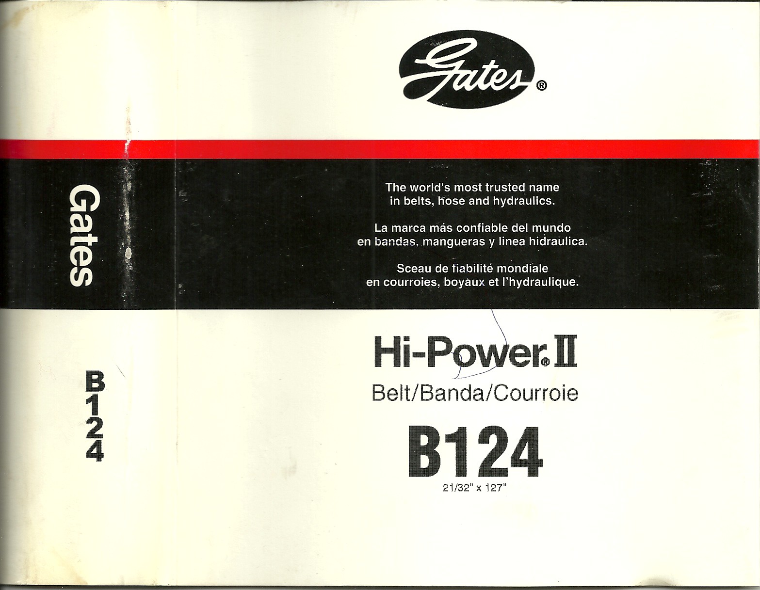

Gates Hi-Power II Belt B124 (21/32" x 127") fits my RM48. ... got one from O'Reilly for $32.99. If you can wait, they're available on-line for about $22 shipped. I had a hard time getting it on with the idler spring in place. So, I took off the spring and used a nut and washer instead to give enough travel to position the pulley so the belt could be put on. I ran it for a short time w/out the idler spring, then adjusted the tension. After the belt had been used a couple times and stretched, it was easy to reinstall the idler spring etc.
