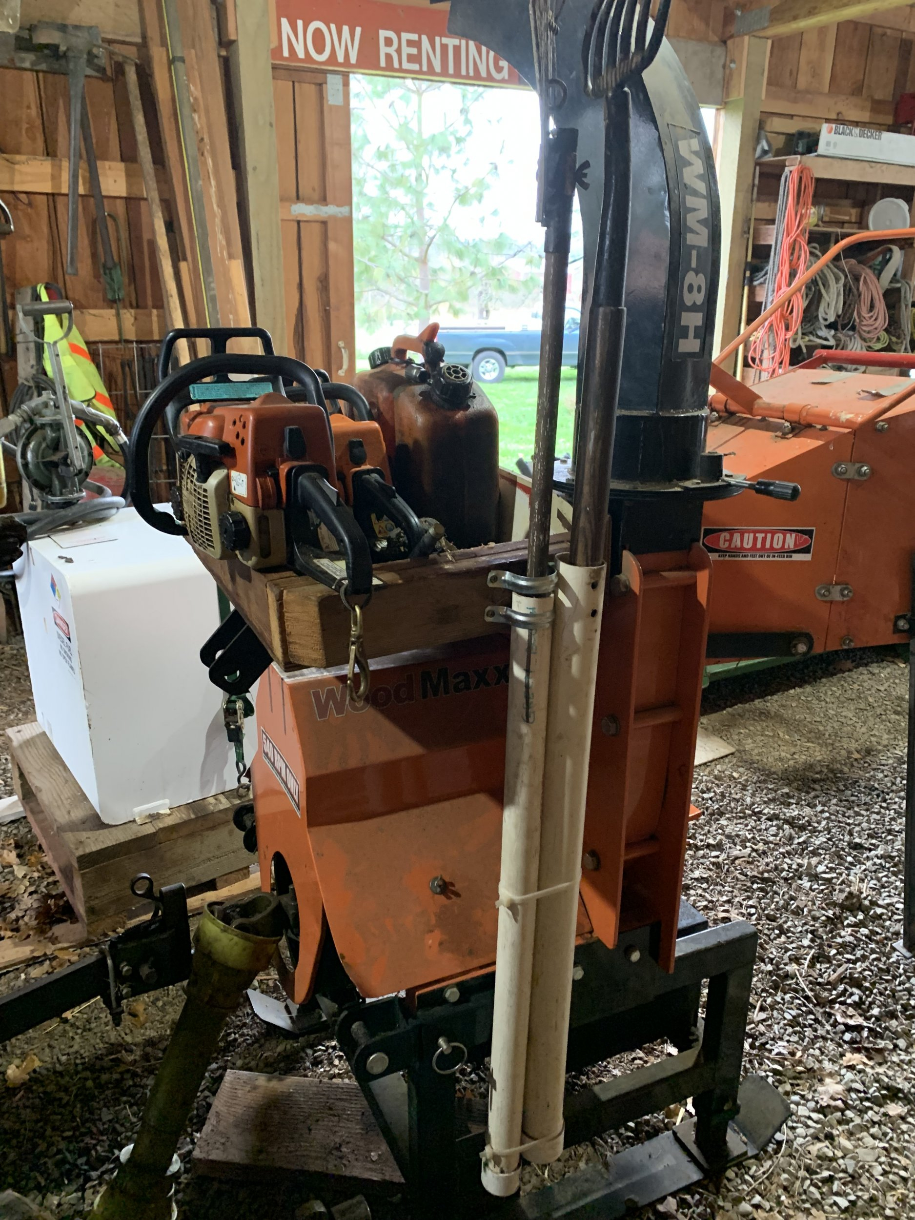

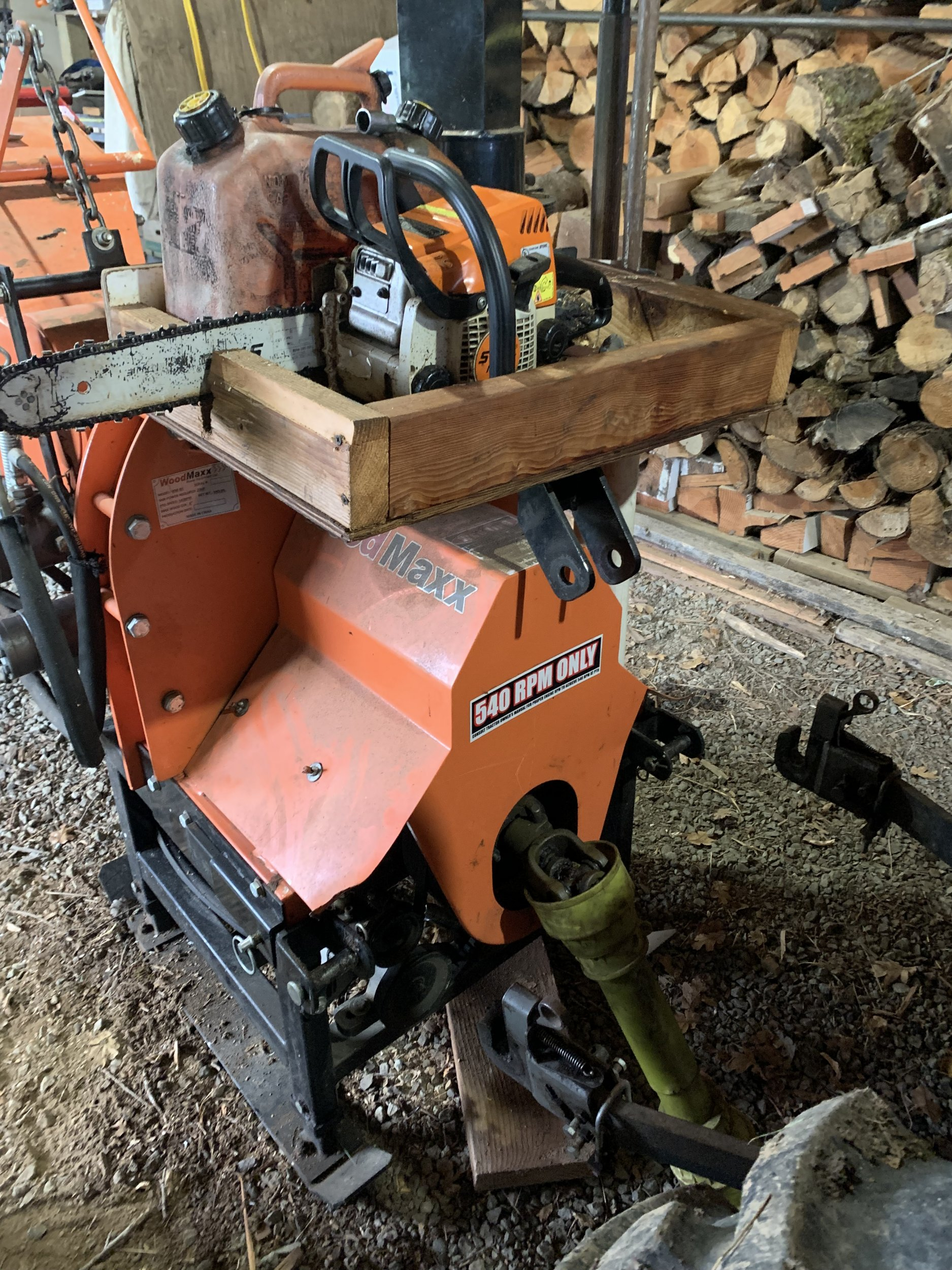

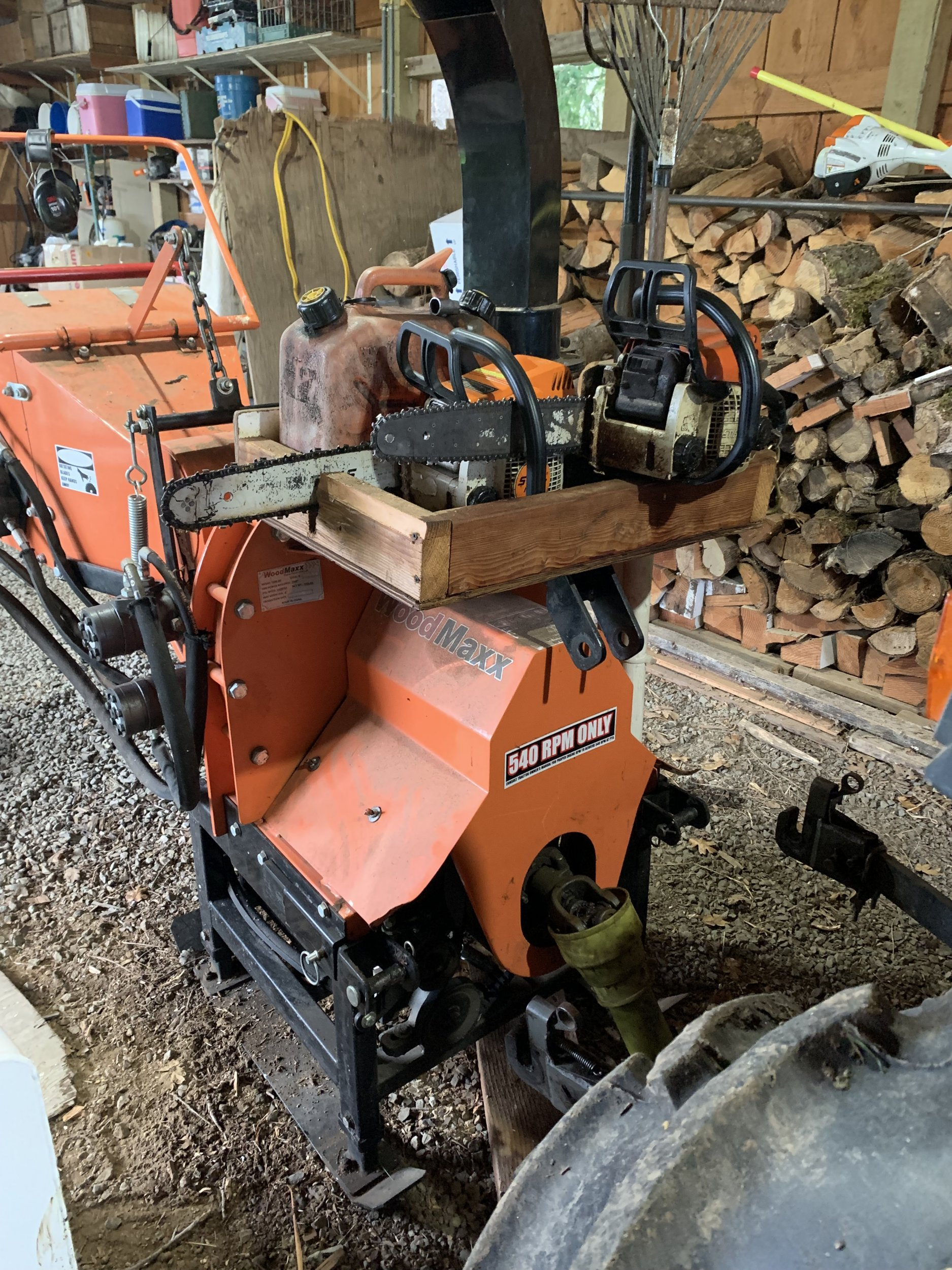

These two additions make sense when I am working in the orchard and need to do some real clean up. Two pieces of pvc pipe, cap glued on the bottom with drain hole drilled.
Plywood and two by four box fastened via one bolt and one pin. Box come off when doing maintenance.
