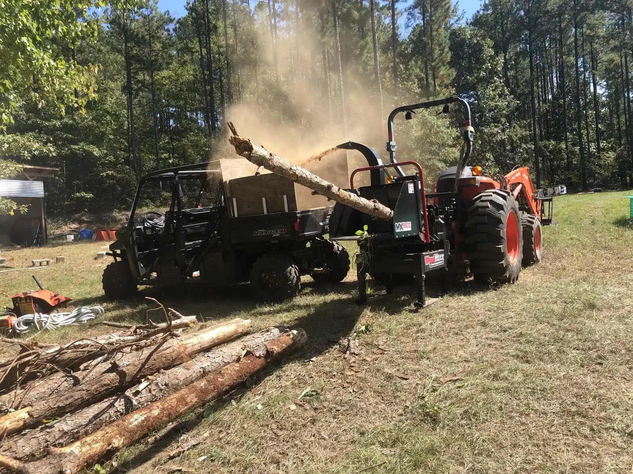

Well that's a pretty even comparison then I think. The comparison doc at the front is probably a good place to start. I personally went Woodland Mills for the clamshell. But you may prefer the straight chute instead of the angle. Lots of videos and threads here about both.

Other than not knowing if my little tractor can handle these, the main difference I see is that the WM-8H is not available at the moment. If I needed it tomorrow, then that narrows down the choice. I would be willing to wait if the woodmaxx is the better choice though.
   / WoodMaxx WM-8H vs Woodland Mills WC86 #35
Flywheel is going to do a lot of your work, especially when you've got less PTO HP to work with. The WM has 100# on the WC.
You're running it on a short ish tractor, adjustable legs are probably a very nice thing to have if you'll be operating in rough terrain so you have as much clearence as possible and keep the PTO shaft orientation where you want it while working or working height for the feeder.
I might be bias, I have the WM-9900. When I was shopping the top contenders were Wallenstein and WoodMaxx for me but the WoodMaxx won out mostly because it seemd to be more USA made.
