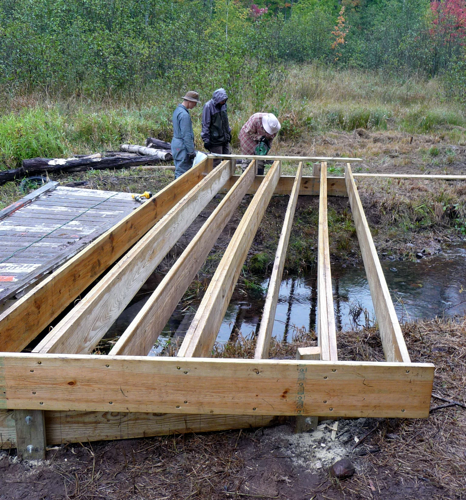

Seen here is one of many bridge we built or helped on. From this experience, we now build them higher off the water, longer and stronger. Had to do them all over again!

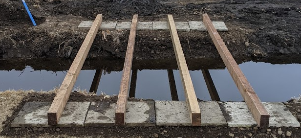

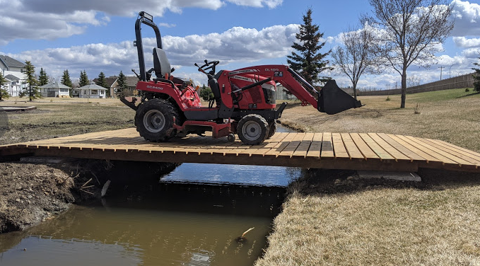

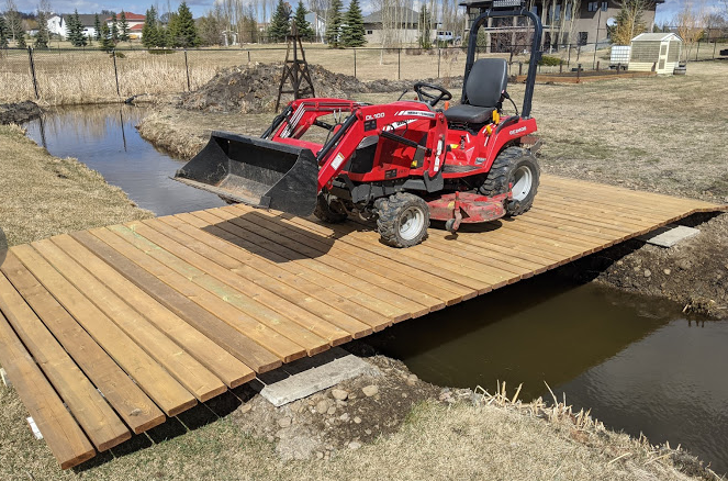

I just built this once Spring arrived. Five 4x6x16' (corrected, NOT 2x6x16 as mistyped before) pretreated timbers on edge to span across; resting on gravel/sidewalk blocks. 2x6x10' pretreated for the decking. So far so good with my little Massey (~1500lbs) and no worries pulling full size utility trailers across without going over the edge! :D

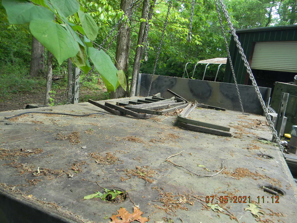

Being on some military vehicle and camping sites I see heavy truck beds taken off trucks so a camper can be built on the truck. These excess beds go for cheap. For example, FMTV beds come in 12.5 ft and 14.5 ft length and would be more than adequate for small streams. Prices run not much more than you would pay for just the lumber to build a bridge. I am attaching a photo of a bed I removed, but in TN. 8 ft by 12.5. Check the SELL threads of places like Steel Soldiers.

I just built this once Spring arrived. Five 2x6x16' pretreated timbers on edge to span across; resting on gravel/sidewalk blocks. 2x6x10' pretreated for the decking. So far so good with my little Massey (~1500lbs) and no worries pulling full size utility trailers across without going over the edge! :D
2x6 on a 16' span?
Lotta flex, even with only 1500#.
Not me brother!
   / Wooden bridge for 2000# tractor to cross creek #29
2x6 on a 16' span?
Not me brother!
Correction: 4x6x16', not 2x6x16'! (hahaha)
3' on each side is supported, 10' is in between.
Before adding the fifth.
