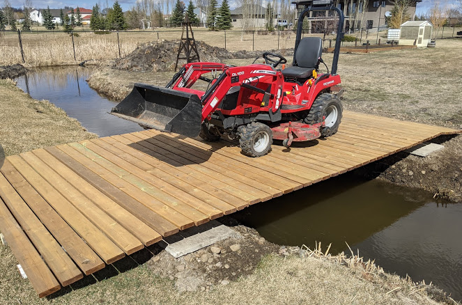

if your decking boards are individually cantilevered outboard of the 6x12s, strapping all the ends of all your decking boards together would distribute your load among several adjacent boards.

How wide are your wheels, on the 2000lb tractor?
   / Wooden bridge for 2000# tractor to cross creek #13
If you can try and find a sawmill that can cut up some spruce for you, there is a mill in Drain just off the 5 you could try. Spruce is tough stuff and is traditionally used for scaffold planking and really takes a beating.
The type of spruce that I am familiar with also rots more rapidly than most other lumber.
Hemlock is a bit more rot resistant if you have any in your area.
The OP does not mention the span of the 6x12's, but dead load weight must be considered.
I would suggest keeping the decking material weight to an absolute minimum.

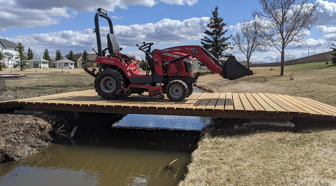

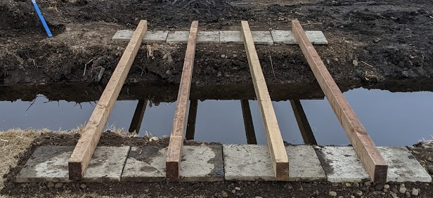

You need to check the weight you can load onto 20 foot long 6 x 12. I think you would be ok with the JD x330 as it is around 500 pounds but to go any heavier I do not believe the beams are big enough.
   / Wooden bridge for 2000# tractor to cross creek #16
Two problems!
Very long span for 6 x 12, and only two beams!
I would not put more than 500 pounds live weight on that bridge!
   / Wooden bridge for 2000# tractor to cross creek #17
BCP - that was my exact thought. Build it for your 2000 pound tractor and somebody, like me, tries to cross with my 10,000 pound Kubota. And you can assume that a whole lot of folks have no idea how much their tractor weighs.
What if a friend attempts to drive across with a pickup load of gravel.
   / Wooden bridge for 2000# tractor to cross creek #18
20’ isn’t very far. Look at some trailers and see how they are constructed. Wood scares me because it rots. I wouldn’t assume the 6x12s are good if the 2x6s are rotten. I would replace the main beams with some I-beam. Steel supplier should have charts for acceptable load on a 20’ span. Might even go with four beams so your decking doesn’t have to be as strong. I have fell through a wooden bridge in a pickup and isn’t fun. I didn’t crash into the creek but two of my tires broke through.
   / Wooden bridge for 2000# tractor to cross creek #19
I vote for this.
   / Wooden bridge for 2000# tractor to cross creek #20
If you have a concrete abutments I would look for some salvaged steel I beams to replace the 6 x 12 and use at least three, and then your problems should be solved. Steel isn’t cheap but you will only fix it once.
