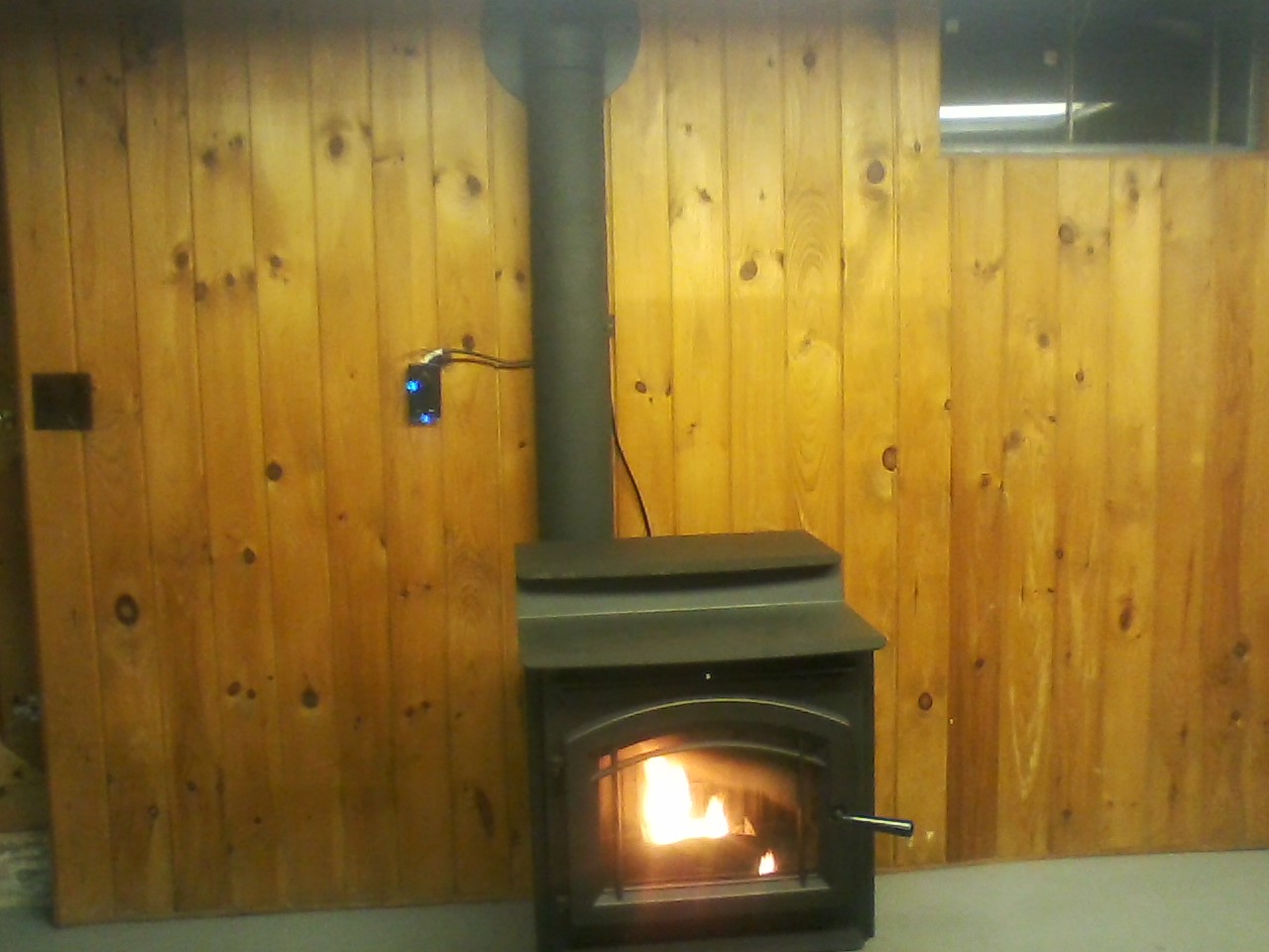

I have a Enviro m55 steel running it for 3 years now . Paid $208 per ton at hd for pellets I run it 24/7 1117151702-00.jpg
