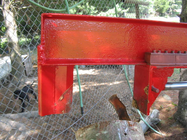

Check this one out.
I think that I would add more bracing.

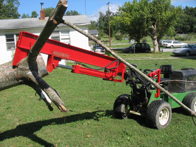

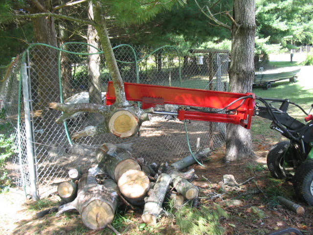

/ Wood splitter #76
This is the other end.

/ Wood splitter #78
Why not do what Stray did and mount it up on the dash of the PT and install some hyd quick connects near the cylinder.
You are going to smile at this, but did you know that they make a remote control valve so you don't have to be near the valve. They are not cheap. I have seen them in the Baileys catalog.

#79
I will bring this to the front because many of this forums members had good ideas if one was buying everthing from scrach. I had a lot of the material for mine thus it didn't cost much. Read this over and if you have any questions I or some one will be glad to answer them.
