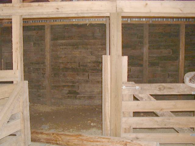

   / Wood Retaining Walls #23
With lights.
   / Wood Retaining Walls #24
Larry's pic looks about like what we are doing. We have a hill behind the workshop that has encroached over time...threatening to rearrange the architecture of the shop! We're digging out about eight feet into the hill, tapering it back and building a 150 ft x 8 ft high wall using locust posts sawwed flat on one side and spiked with 2x10 treated planks. Figure the posts will be about 12 ft long sunk into the earth 4 ft about 5 ft apart. We'll use deadmen and also a shed roof (wood drying and storage sheds). That way the roof joists and front posts with diagonal bracing will help keep the whole affair stout. Also, instead of backfilling, we plan to let nature take its course as regards soil filtering down. From all I've heard it appears the biggest concern is moisture, so we'll use, as so many here suggest, gravel and drain tile to vacate runoff.

   / Wood Retaining Walls #26
Really like what you did with the retaining wall. Couple of questions, did you put some type of draining materials (rock, pipe, etc) on the outside of the retaining wall?
When completed are you leaving the floor dirt or cementing?
