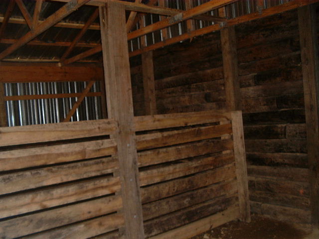

The retaining wall I built for my barn is made with Railroad ties for the wall and 6X6 treated poles for the support. The wall is 30 long and 10 high. Here is a pic of it from inside the barn.
Steve
