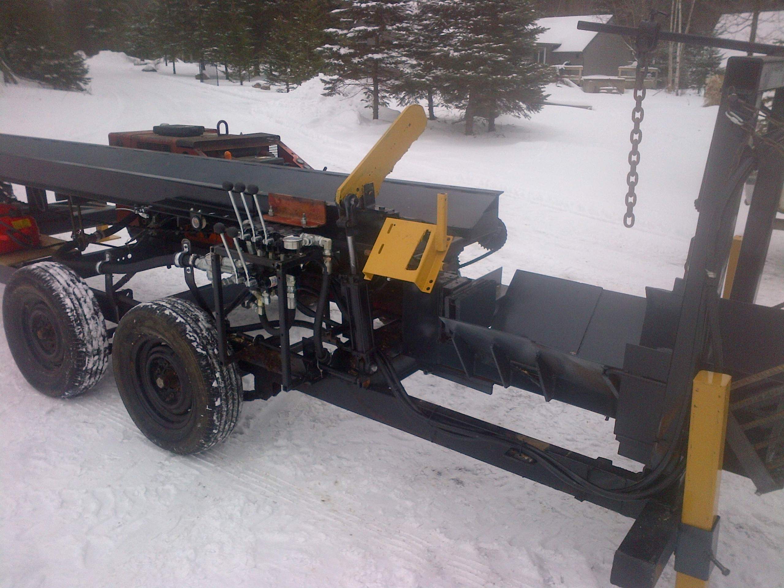

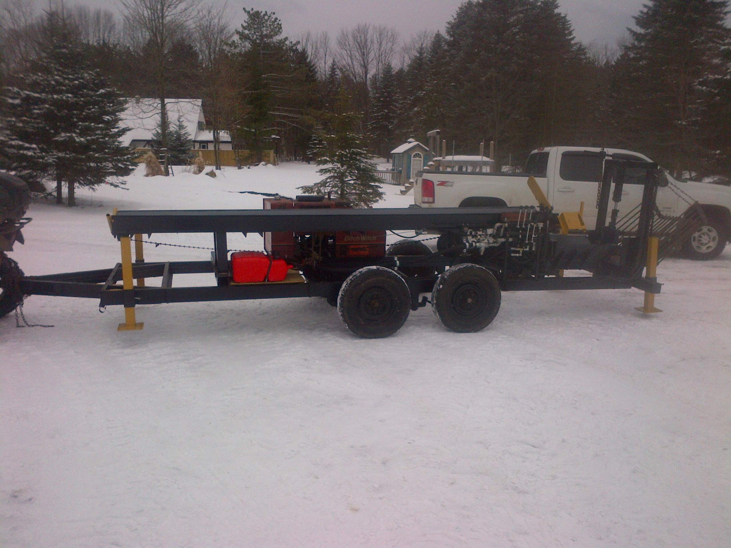

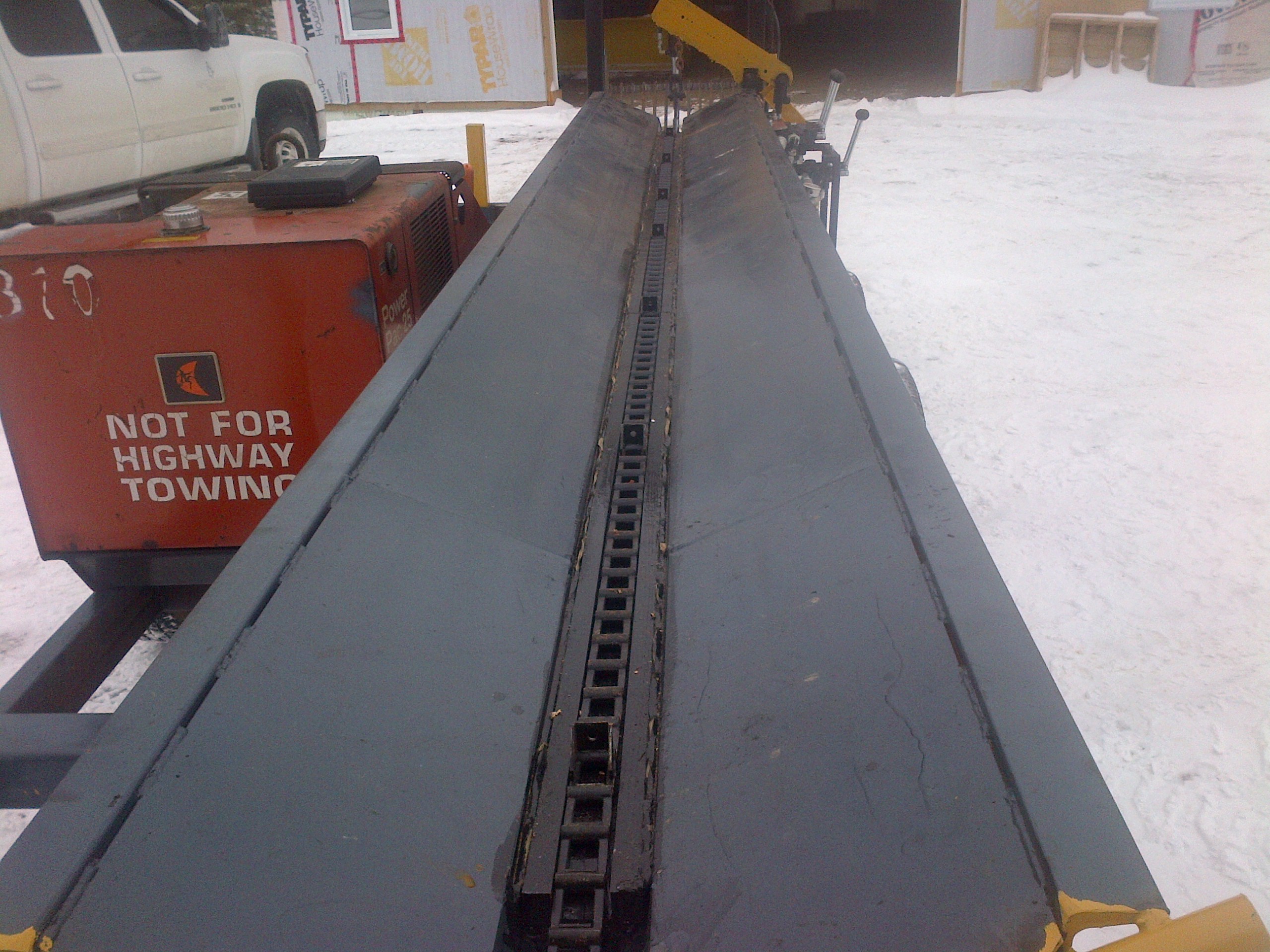

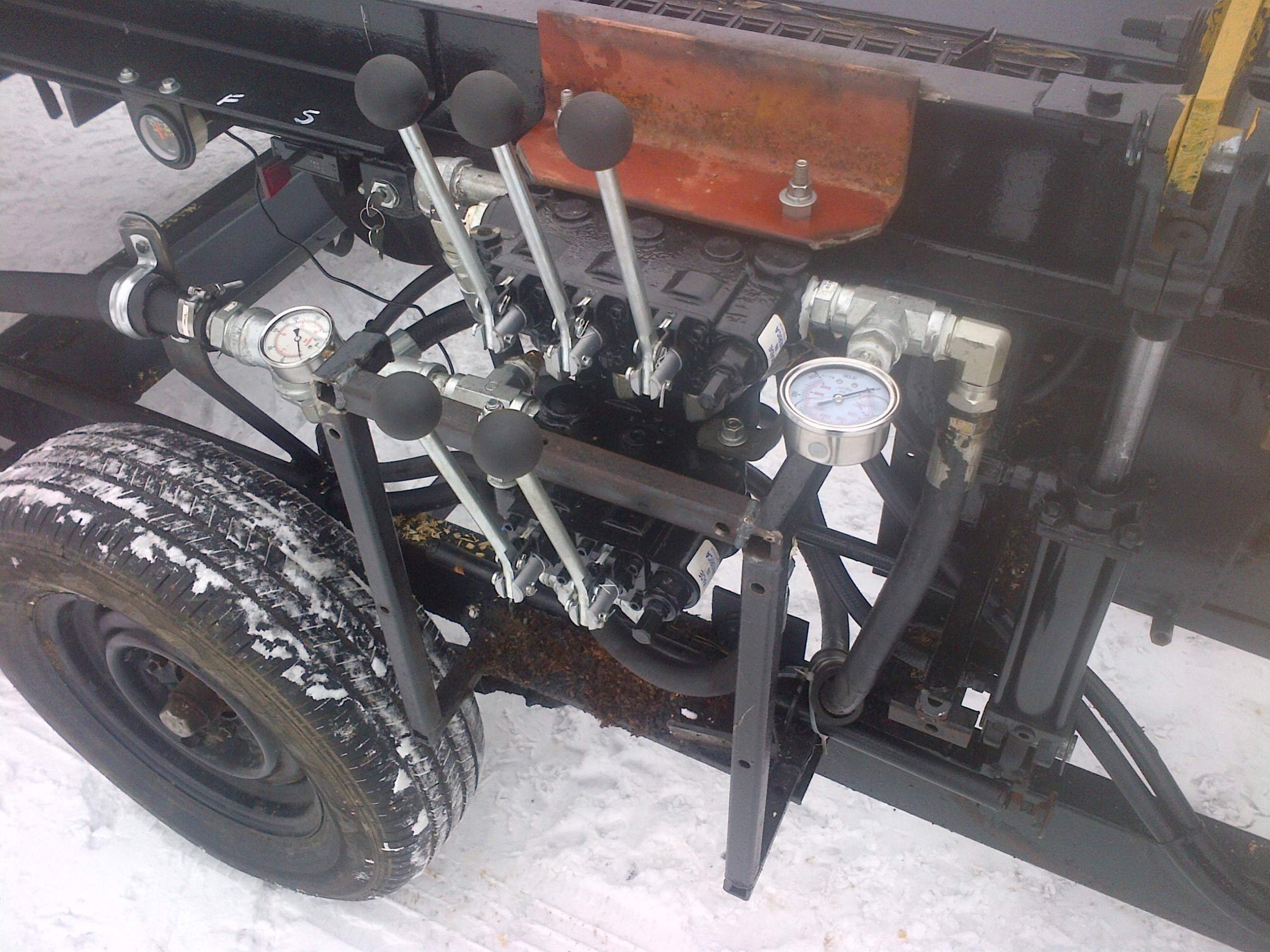

Here are a couple pics of the finished product. Video coming soon.

Looks good How far apart are the paddles on you feed chain. When I made mine I made my infeed table 10 foot and I wish I would have made it longer. I have a spliitter on mine and it can take up to 24 ich long pieces.
   / Wood Processor
Re: Wood Procceesor
They are 2 feet apart. Infeed is a little over 12 feet long with no problem taking 16 foot logs.
   / Wood Processor #5
what did you use to make the saw come down.When I built mine i use a pressure reducer and a flow reducer...Works great
