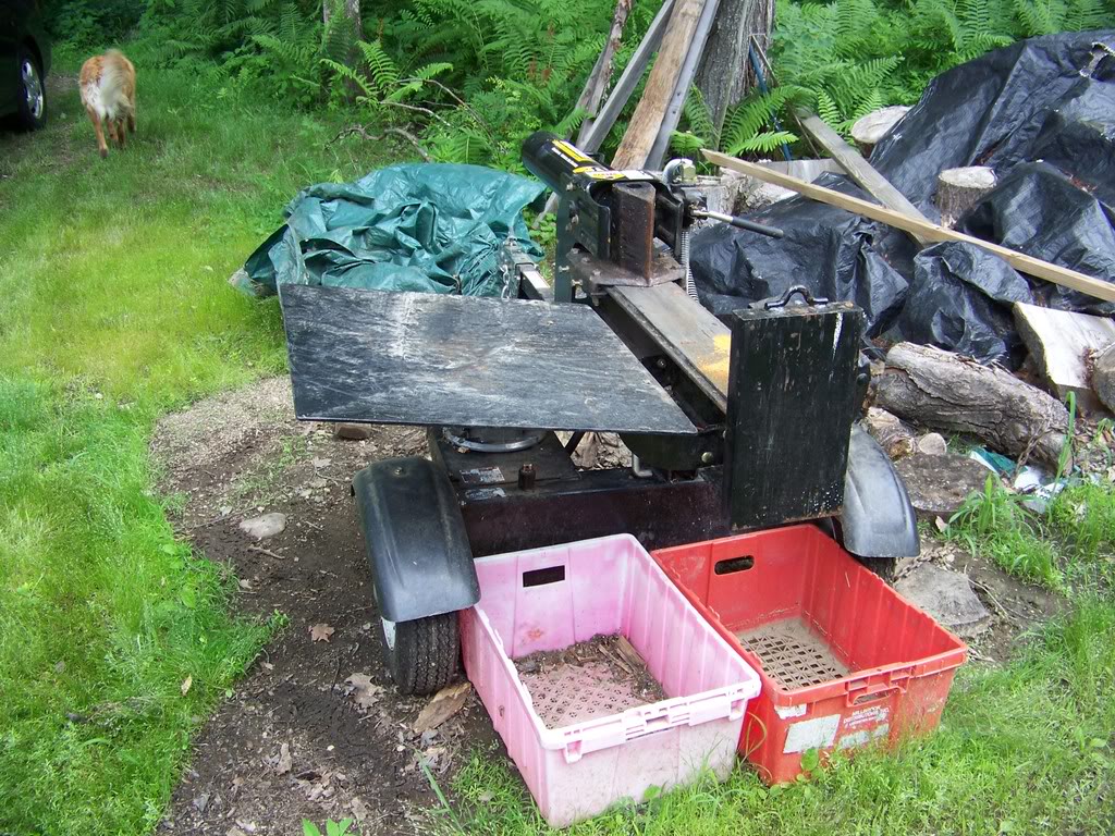

I hang the splitter on the side of the 3 pt carry all, chainsaw, fuel and oil in the FEL and idle off into the bush. Last year and this I have been blocking up and splitting trees that the wind took down in a big storm last summer. I cut a bunch of blocks, split them onto the carry all, when it is full I drive back up behind the shop and pile the wood. I find that way I don't play myself out going too hard at chainsawing or muscling blocks onto the splitter, the drive back and forth to the wood pile gives me a little break. I can keep a pretty steady pace all day, surprising how much wood that can be.
Should be a photo attached showing the carry all on the B7610. Since then I have extended and strengthened the carryall and made a better mount for the splitter. In this photo I was trying the splitter out with it just C clamped in place.

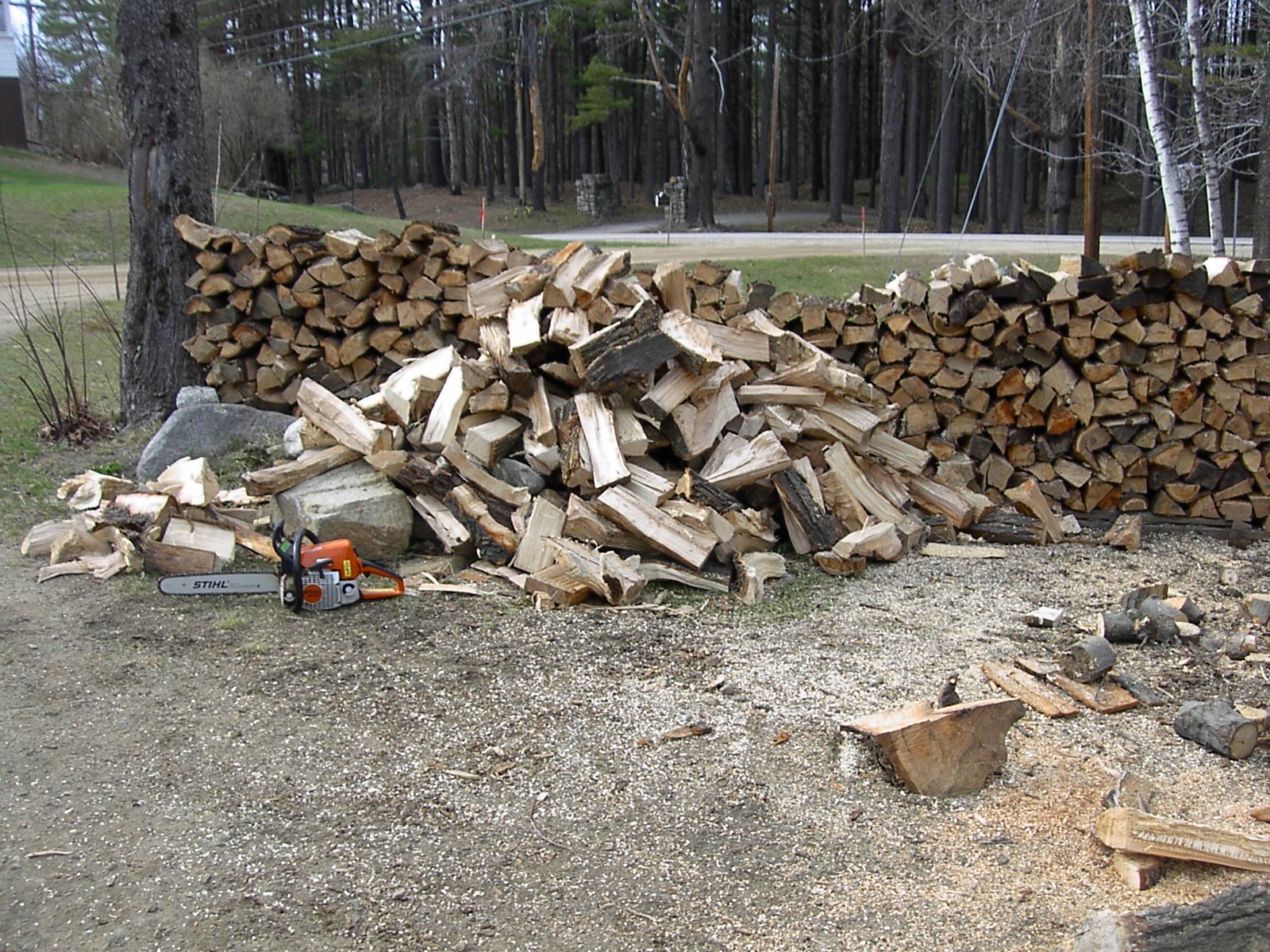

I do it differently. I want to remove the tree to clear the woods while also getting firewood. Don't want a mess out of my woods so I fall the tree and then drag it with the limbs still attached to the limbing area. If the tree is too long I cut off the lowest section and drag it to the limbing area. Once there I get of the tractor and limb the tree. Then back on the tractor and drag the log to the log stack. Unhitch the tree and then go back to the limbing area and shove all the limbs into the limb pile which is quite large and is right next to the limbing area. Round and round I go until a sizable stack of logs has been accumulated.
I should mention that my woodlot/property is 50 miles from home.
I return to the woodlot with only a truck and trailer and fill the truck and trailer with about 2.5 cords of rounds. Drag the trailer home and dump near woodstack area. Split the wood into a pile and then stack, stacking is the least fun part.
Today I have 13.5 cords stacked on pallets plus another 4 cord heap that I plan to sell since the 13.5 cords represents three full seasons of burning.

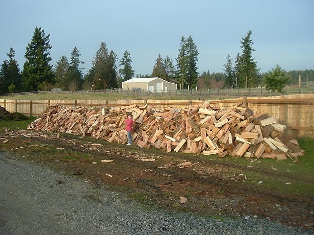

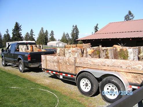

Unfortunately, we don't have enough trees or property to heat our house every year, so I have to drive to the free wood. Pack up the saws, tools.... hook up the trailer. Get my helper and off we go......

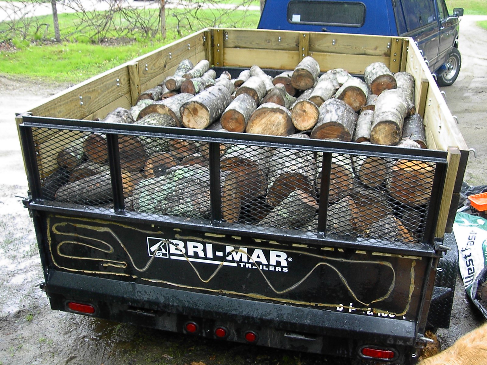

I usually drop off my haul at my in-laws, where I split and stack everything to season. I also do a couple cord for my inlaws, and if I have enough I've been known to selll a cord or two. I don't mind working with the big stuff, since my late FIL was always looking for an excuse to fire up his Bobcat and set the big rounds on the splitter for me. One small mod I made on the splitter...... a shelf to hold the rounds while I'm splitting. Saves the back from having to bend over and pick up the same chunk over and over again.
