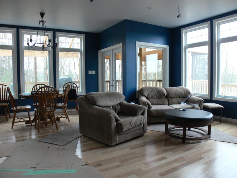

I used engineered hardwood over my radiant floor heat, and selected hickory. It's got a great coloration and is very hard, and my builder neighbour always comments how much he admires it and he is using that from now on in his project houses. :)
