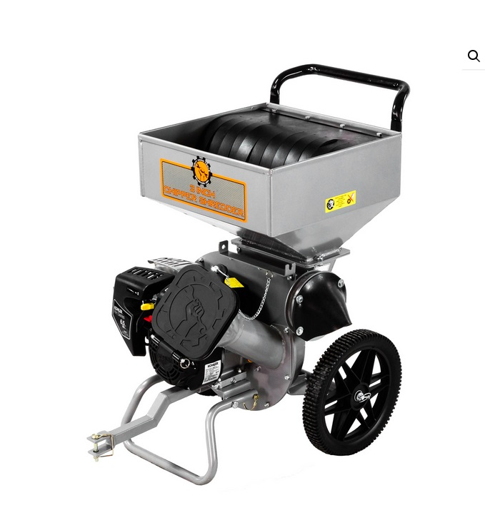

Just so everybody knows this is the chipper/shredder being discussed. It is only a residential unit, It's 3" capacity is not the same as the Wallenstein BXM32 :)
Yep, that's the one, except different discharge deflector.

Guys, anybody done such a mod? I got a Dirty Hand Tools 3" chipper/shredder, but the chip size it makes are tiny, almost fit for compost. I'd live to increase chip size, make it more usable for mulching. Is there usually an adjustment for the anvils in there? I don't know much about the internal workings of these.
Most have a bed plate. Just adjust it to be farther away from the blade.
   / wood chipper/shredder mod to increase chip size #20
increasing the gap only leads to poor chipping performance, excessive strain on the knives, quick dulling of the edge, the only true way on a chipper to increase the chip size is to increase the material input speed. If you think of a pair of scissors, how poorly they cut if loose or if there is a gap in the blades. If the gap is large enough, they won’t even cut. I own a Vermeer chipper, and I can slow the feed down to almost make sawdust, or speed it up and make inch or more chips.
