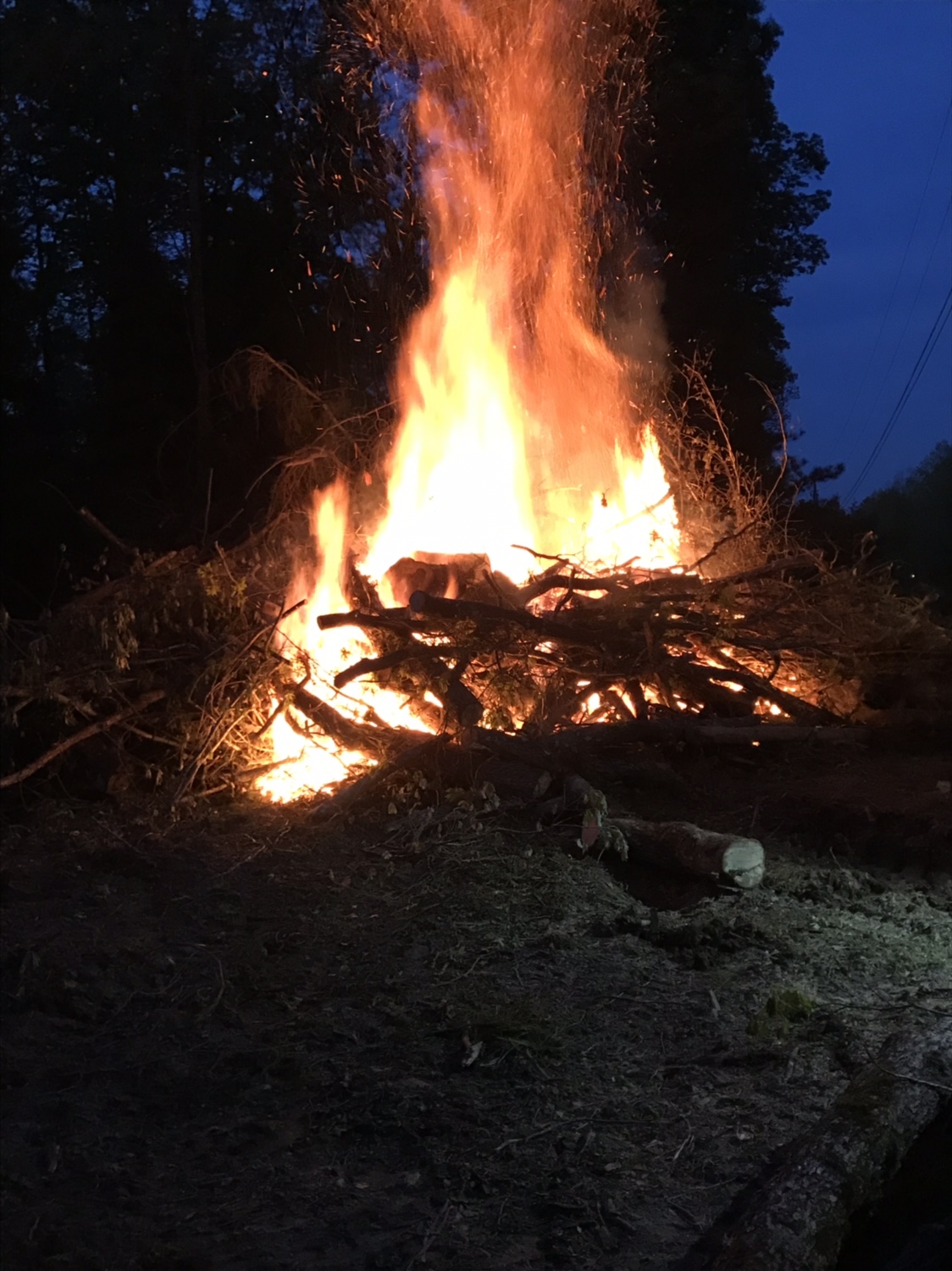

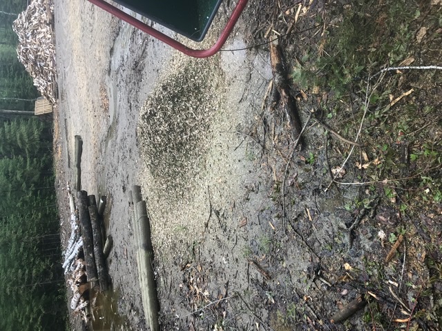

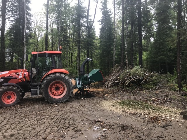

I have a woodland Mills 88. i have lots of HP but, i'd say get the biggest one for your HP. It's not all about the size of a log you can chip, it's also the size of the opening into the chipping flywheel, which the bigger, the better, as you won't have to trim as many limbs off, worry about crooked branches etc. i'm running mostly 2-4" stuff through this 8", but with all the limbs on.
This pile woulda been a good night of burning in the fall, but i'd have had to wait, work around it, then stay up 1/2 the night tending to it. In less than an hour it is turned into $100 worth of garden chips/mulch. (actually that picture was not the whole brush pile, just a portion of it.) D7400772-6588-4C3E-B687-6FE476AB7FA8.jpegDC4D8261-1CA5-4254-9D64-0FBD380B10CD.jpeg

There’s always the free option. View attachment 659022
Thats me. Had a power infeed pto chipper and sold it. Much easier roasting the limbs, less aggravation, no fuel (except the accelerant to get the fire going), no piles of chips and no maintenance on yet another implement.
