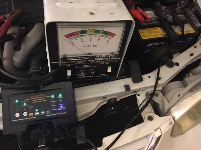

Here is my battery testing tools
/ Won't start after recharging battery #15
I have the same charger, and love it. I have been topping off my diesel transfer pump battery recently, and the charger has just started indicating the battery is "weak" based on whatever voltage, load, and charging data it's seeing. The battery was marginal when I took it out of the wife's car, but I'll use it up pumping fuel.
In addition to real load testers, I use a Midtronics electronic tester that is surprisingly accurate and is great for tracking the overall decline of battery capacity.

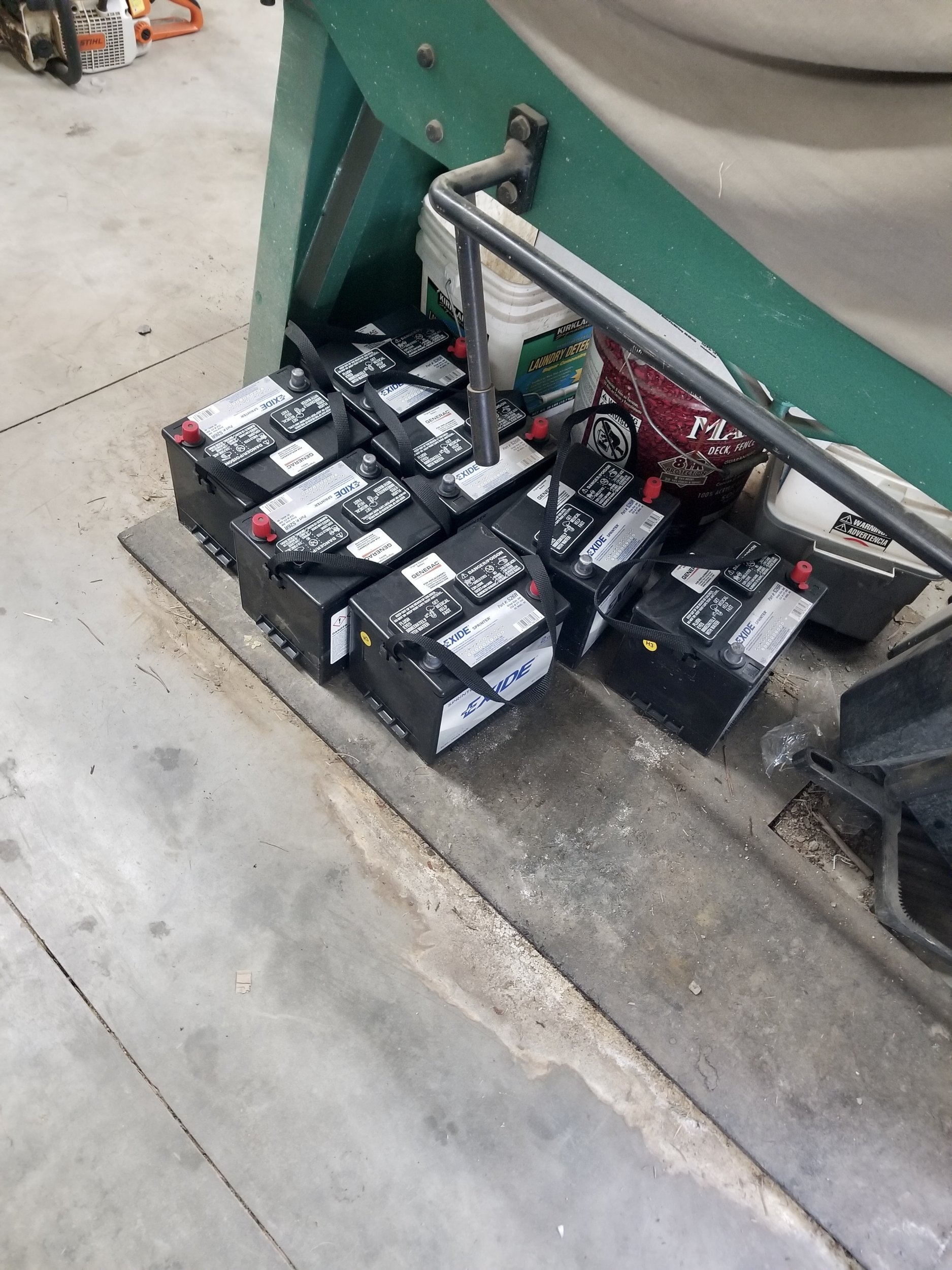

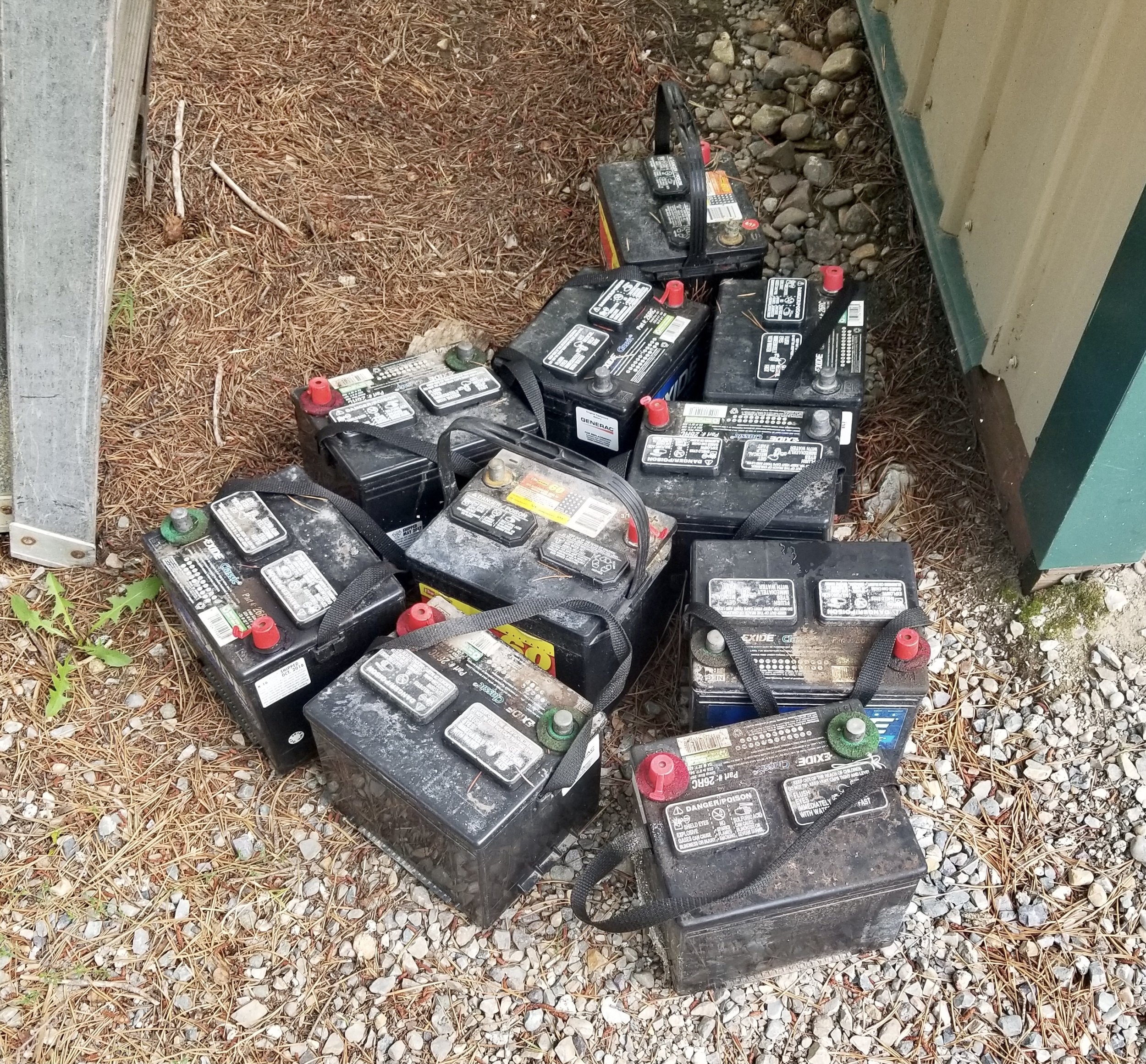

This is pile of dead batteries from last month, awaiting for exide to pick up.
this is their available replacements, plus 3 on service truck. I do get tired of storing them between pick up and delivery though. Dont like the mess nor the acid that results. I doubt i have a pair of work clothes that dont have acid holes.
