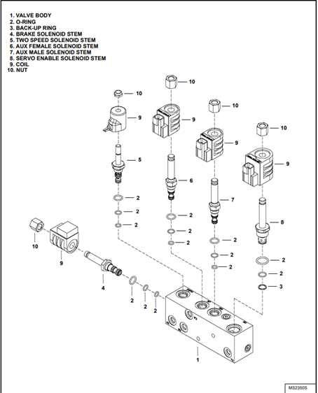

Just got my hands on the service manual. My best suspicion right now is a bad two speed solenoid in the pilot manifold. Ruffdog, I assume that's the same as the Control Module you are referencing? I'd hate to go digging around in there on just a hunch but not sure what else it could be.
   / Wont go into gear #14
No, that is something else. Lots of dodads in these things.
