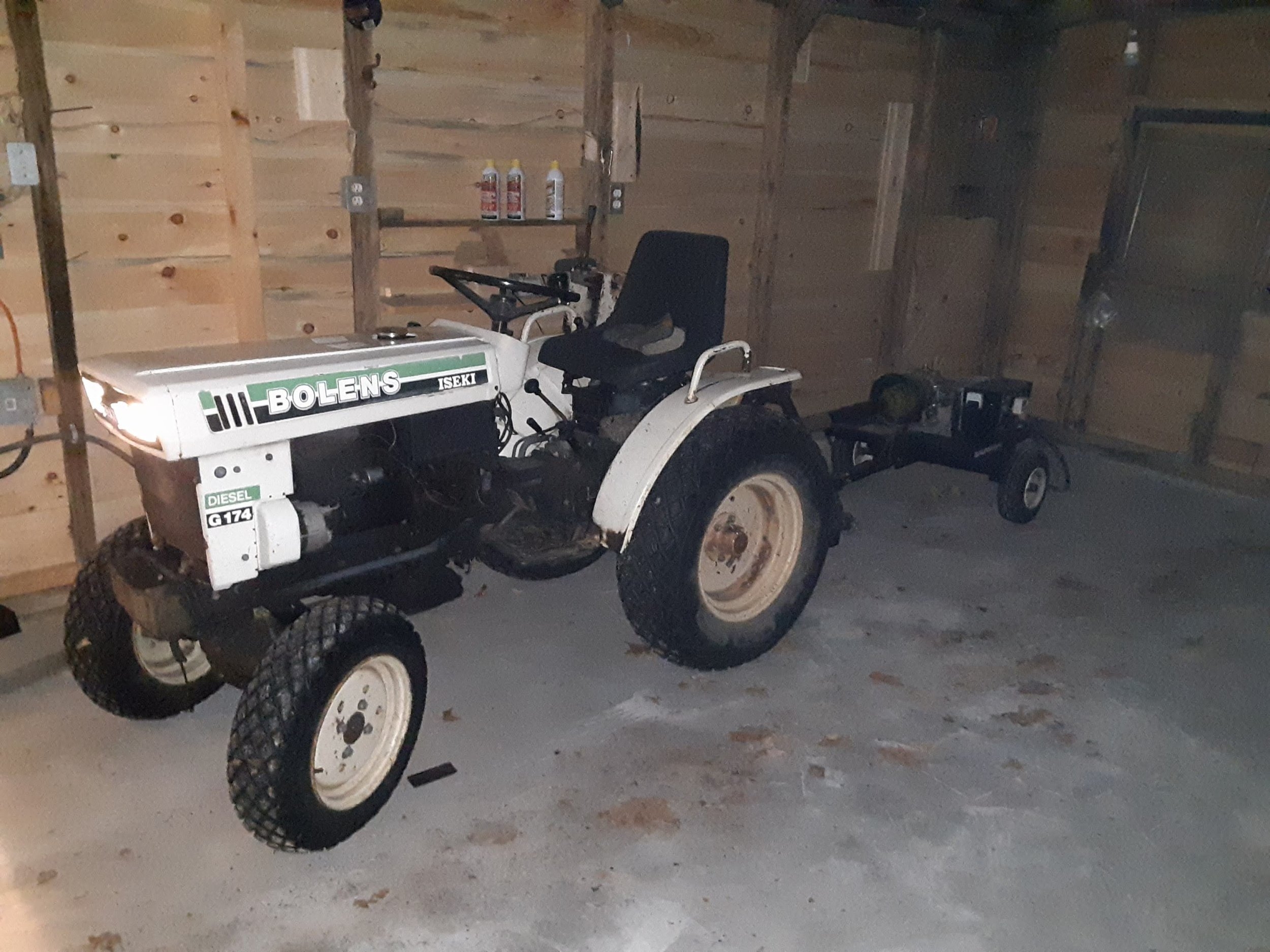

As I first posted here in 2011, I run a 7.5 KW Baumalight generator attached to my 1980 Bolens G174, running in PTO gear 2, which delivers
740 rpm at 2500 on the engine's non-existent tach. With a Kill-a-Watt meter now plugged into a wall outlet dedicated to the generator's output, I can monitor it quite effectively. It probably runs the generator twenty hours per year.
My new problem involves maintaining a steady engine speed once I get the revolutions set at 60.8 hz, the setting I find works best over the long term, because it drops a bit under load. But the old tractor likes to slow down on its own. That's not a problem apart from generator duties, but I need to understand how to tighten up whatever in the linkage has worn or become loose over the years.
At which end of the throttle control on the tractor do I start?
Thanks,
Rod
   / With a Bolens G174 at which end of the throttle control do I start for a steady generator speed? #2
It sounds like the slip nut on the throttle lever needs to be tightened and or a new plastic washer added between the lever and pivot
Thanks for getting back to me.
Two videos online yesterday seemed to establish the principle of the friction nut. The nut on the Bolens was easy to see from above, except that it had a large cotter pin through the 19 mm bolt. Eventually I got the cotter pin straightened and removed with a pair of long needle nose pliers. The nut adjusted readily and solved the problem of keeping the engine at a constant speed. Putting the key back in gave me a lot of sympathy for heart surgeons. All I could do was smear Loctite in the general area of the bolt, tamp it down with the pliers, and run the engine for an hour to dry the goop.
The generator remained at 60.2 hz from beginning to end of the test, however, so I guess we'll get through the next ice storm.
With your directions I found the throttle control and the nut to tighten it. I couldn't conveniently remove it because it was tight to a wall on that side with the gennie attached and the family car nearby.
The trick was to keep the screw from working itself out after I tightened it. In desperation (storm coming with dire warnings of power outages) I drizzled white LocTite in the general direction of the washer. Enough seems to have adhered to allow precise throttle settings, so all is well.
