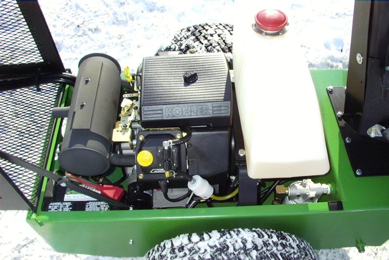

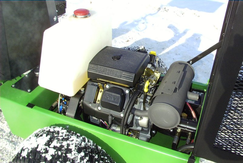

Here's a photo of how my 2001 model year PT425 is laid out (no, the tractor has never been that clean again).
You can see the rear facing muffler with the two-section PTO pump beneath it. The VVP is in front of the engine, almost under the gas tank.
I really like this setup. Only thing I have to watch for is hot exhaust exiting the rear of the tractor has melted the plastic on a few cheap implements! :laughing:

View from other side.

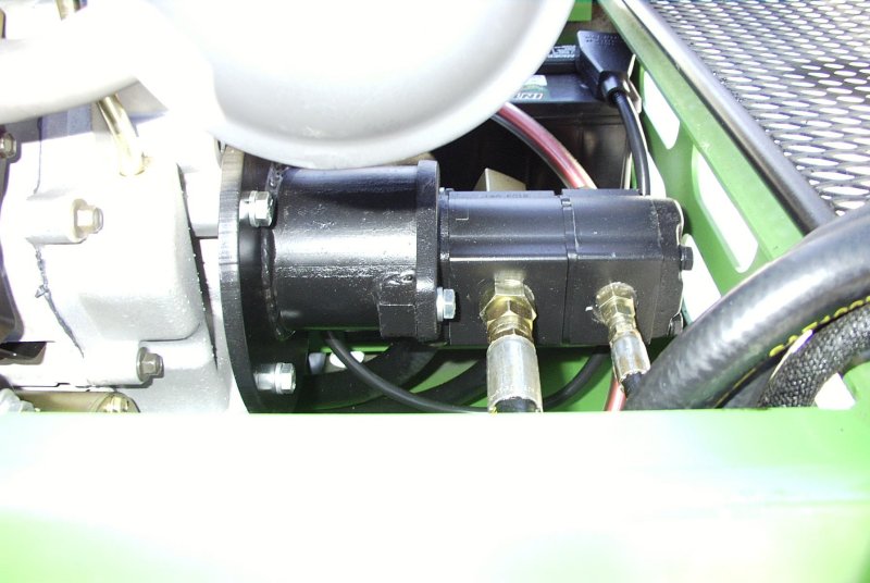

PTO and steering pump.
Notice the pump adapter mounted to the Kohler engine. This is the business end of the Kohler, so, in essence, it is mounted backwards in the engine compartment. Well, not sure about backwards, but the fan is at the front in this application.

The variable volume pump. Notice it is mounted to the shaft through a hole cut in the fan shroud of the Kohler engine. Can't see how the pump is attached to the motor.

Do you think these Subaru engines in the PT's can get 1500 hrs before an overhaul? With the heat, do you think your engine is running at about the same temperatures as Kent's? According to the readings he took, it seems that machine of his is set up pretty good? As far as the temps , that is.
I have a modified exhaust header and Subaru mffler, and use synthetic oil in the engine and hydraulics. The oil may help a bit (e.g., start a few degrees colder), but the switch to the EFI engine helped by about 10-15 degrees. The exhaust modifications help with heat, but it is still an issue and always will be due to the PT4xx tub design. IMHO, the only "real" solution on current models is a cooler running engine or lots of customization.
   / wish to buy a new suburu robin engine to replace current one #20
I see. I notice you don't have a heat shield either. The pumps are right underneath the muffler? In that respect, I might prefer the Robin/Subaru set up, but thats nice to see how the engineering changed from 2001 and obviously that year they built a durable, good running machine.Not that it would be anything significant, but I wonder if the newer PT-425 can lift more than yours, because of there being more weight in the rear of the tub? It looks like you have more available room to work on your engine than mine too?
