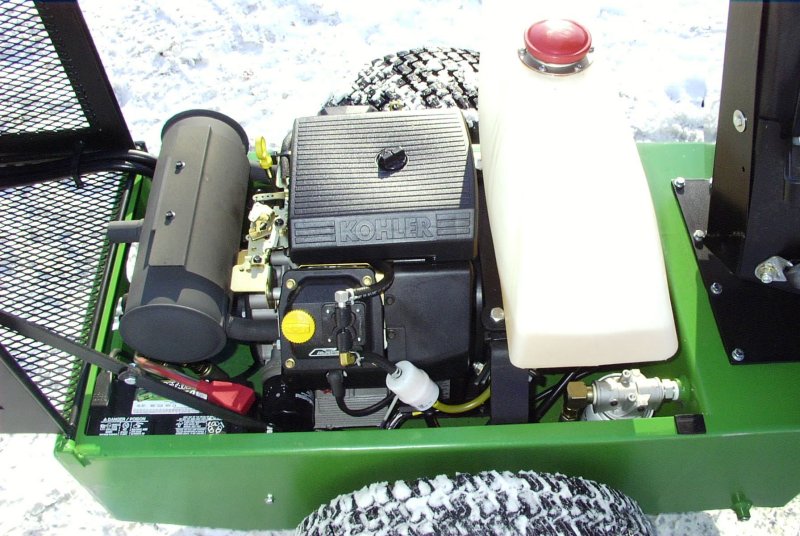

View from other side.
422900d1430351050-wish-buy-new-suburu-robin-pt425viewenginecompr-jpg
One nice thing about the older Kohler equipped PT4xx is that cooling air is drawn from the front of the tub through the engine shroud and out the back past the muffler. There is a lot of openings in the rear of the tub for the heated air to exit. On the new machines, the air is pulled the opposite way, and I wonder if it's less effective since it gets pushed up against the front of the tub with nowhere to go. There could be some resulting turbulence that also negatively affects engine cooling. Just a thought...
