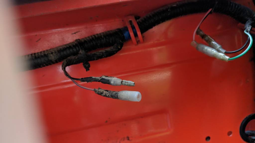

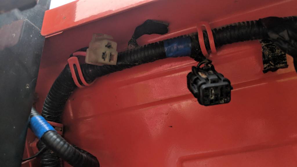

Here is what I found so far on the back of my new to me 2016 5010HS just above the PTO. Three connectors - left to right: A three pin (white plastic), a 6 position with 5 wires, and two bullets.
- The three pin is ground, Constant Hot, and hot when ignition turned to ACC or on.
- The 6 position is clearly for a trailer. Gnd, left signal, right signal, park lights and a 12v hot...all available when ignition is on.
- The bullets are gnd and 12v hot when ignition-on.
My plan is to install a rear facing work light and connect it to the bullet set through a switch positioned in a blank beside the seat. This keeps the wiring short and easy. More to come when the switch arrives.
I will mention that in addition there are a set of bullet connectors on the left and right that are not active in any ignition position. Not sure what they are for. Anyone know?
