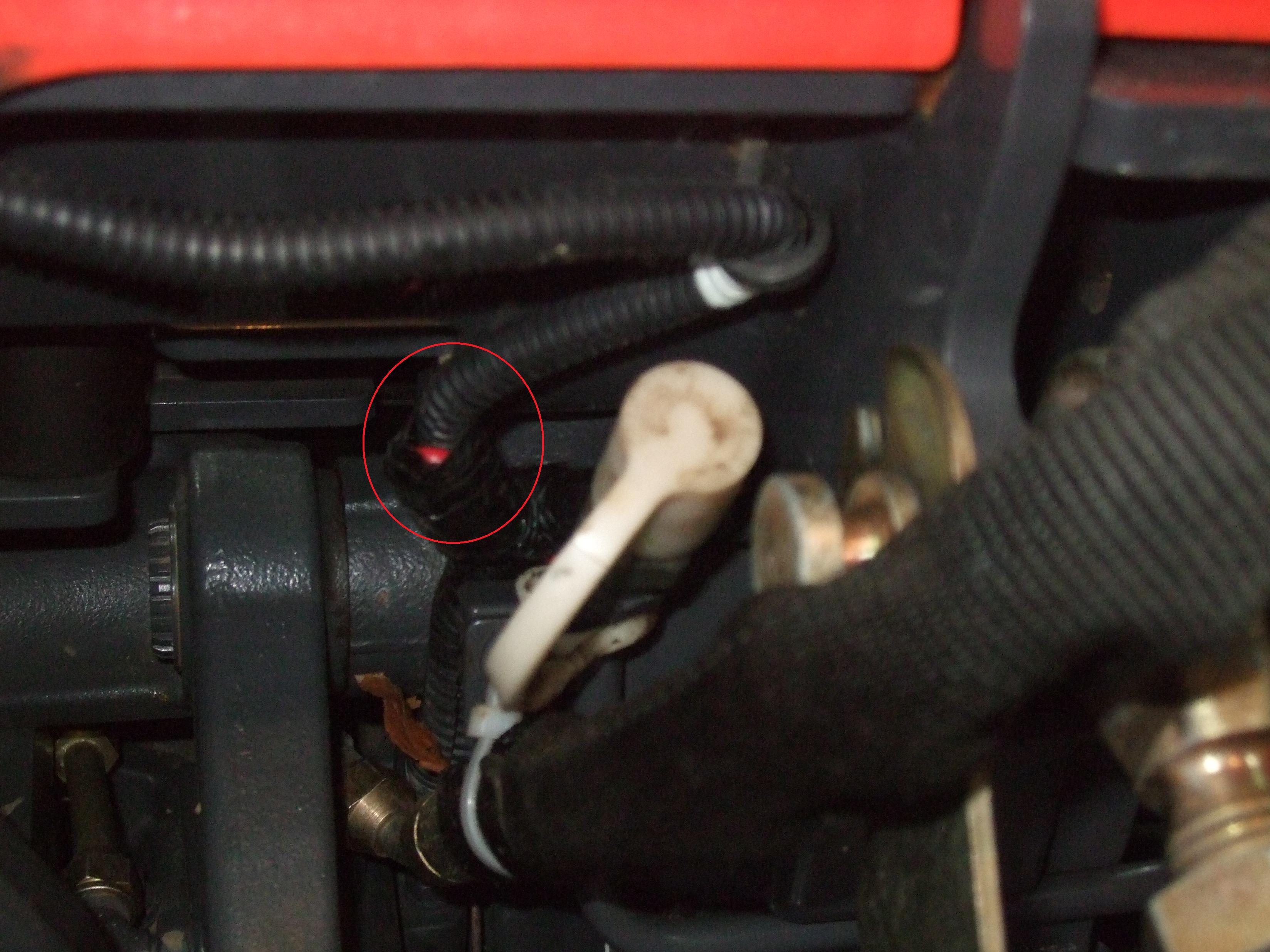

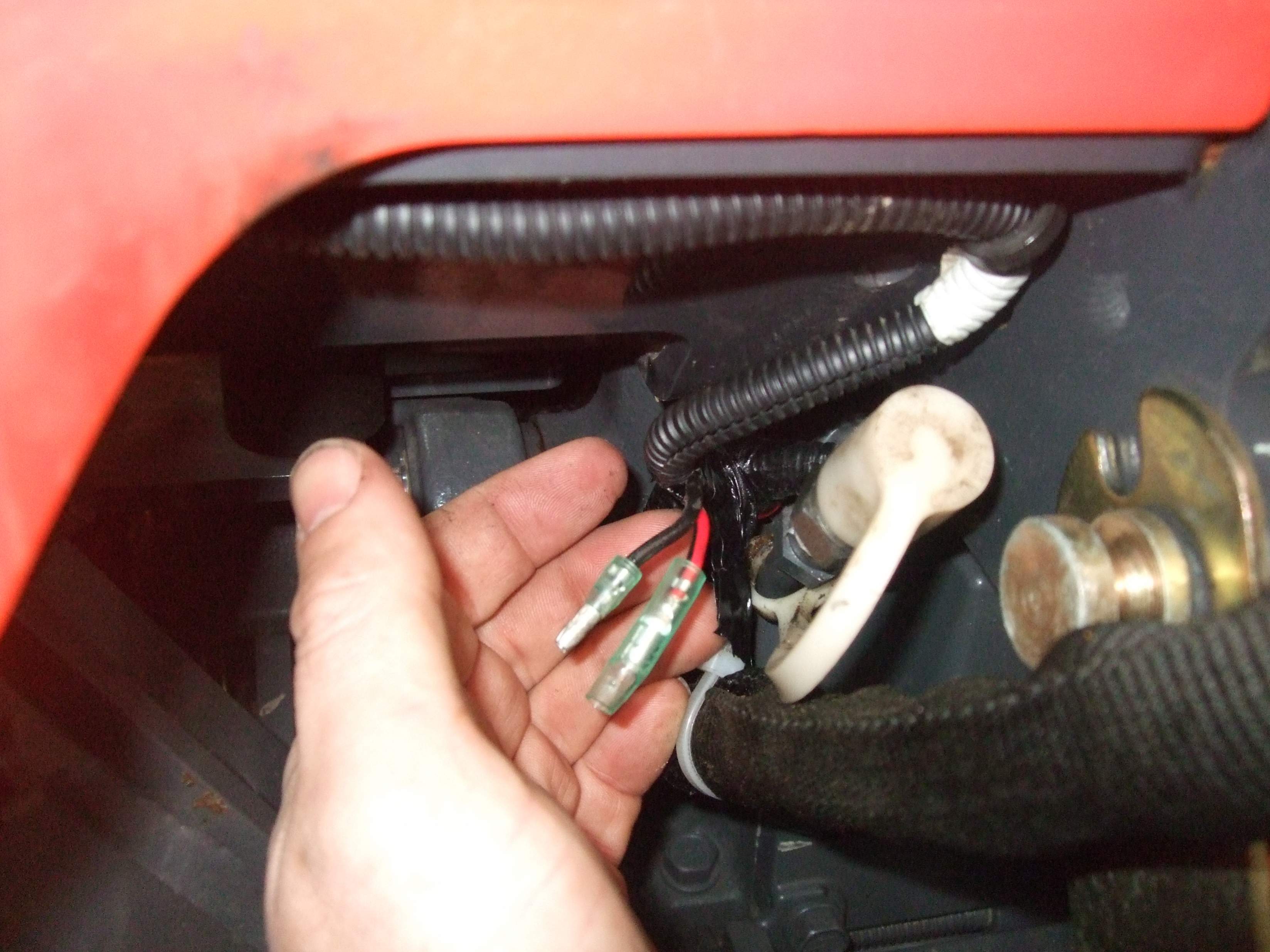

I posted these pics before many times. since you have a 1860, ignore the white cap, its a hydraulic return for backhoe for BX24/25. The wire location is still the same across the BX series.
What you do is look underneath tractor and find wire from rear taillights and find the junction to a y. near that Y is the wire connection you need inside the loom and its all taped up undere black electrical tape. it will not be obvious until you remove the tape.
It sounds harder when reading it- you just gotta do it.
Don't feel bad about doing the work to running new wires. I ran new wires myself for the rops lights AFTER I found those extra wiring plugs. I wanted thicker wiring for the lights and leave the switched power source alone so its available for my sprayer and water pumps .
