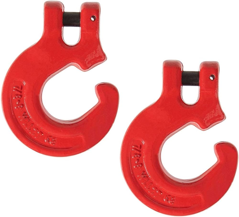

good idea but in practice when pulling trees in the bush those lock levers seem to last about ........ hmmmm......... 1 minute.
these "c" hooks be about same price, available all over, and will outlast my remaining years.
Cheers
Yeah, those are the way to go for skidding with chain. The hooks with the little sheet metal latch are good for stuff where the hook never sees the dirt. Drag logs with them and they rarely last a quarter of a day.

For the log end, I prefer this style choker hook. I have not have any problems with it becoming disconnected from the log. Amazon.com
I don't know if this style can be found preinstalled on a chain you can buy. I had to change out the hook ends on mine.
edit: there is this choker chain with the hook preinstalled: Amazon.com
I use the spring latch style you posted to connect to the tractor clevis on the drawbar.
There is also this style latching hook which I think may be more resistant to bending than the spring latch on the other type of hook, but I haven't used it to be able to say for sure. Amazon.com
Had never seen that third link before. Clip looks much more durable and it's there when you need it and out of the way when you don't. Can you buy the clip separately when you. misplace it?
/ Wire Rope #54
I doubt you can find the clip separately, however, it has a spring engagement on it and it's made of much heavier material than the thin metal spring clasps they put on other hooks. So I don't think you'll lose it. It is more fiddly to engage, IMO.
