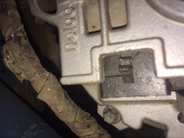

so now we need a picture of the connector ( and pins ) to figure out which "extra wire" is going to be needed on the half converted alt , to make it fully functional ....
some need a bulb / resistor ( or both for backup ) and some just need an extra wire....
but we still need that big wire going back to the battery in any case...

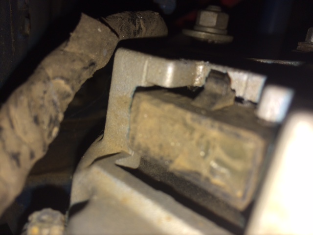

I could not get the cap off, its in a tough spot.

It looks like something has been added to the pins and the connector filled with potting compound.

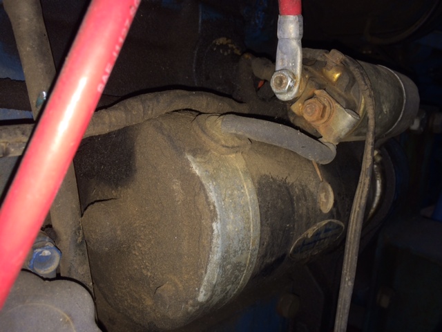

It might be easier to run an 8 gauge wire from the alternator to this end of the new battery wire.
   / Wire from alternator on Ford 1920 #28
yes I saw that too... maybe someone has already "reconfigured" the alternator to a 1 wire unit ...
wire to starter is easier for most of us ...
but sometimes when you "loosen" that nut , the solenoid cracks ... hence the reference to connecting to the battery post ....:)
You'll have to remove "clean" the dielectric grease from the terminals in your first picture.
If you look closely, you can see the pins are named,,SFLP
Here's how to wire them up...
Run a wire from the "F" pin to a wire that has power "only" when the key is on.
Do as the others have suggested in regards to running a wire to your battery or starter,,
then, take a wire and put it on pin "S" and connect to wire that goes to your battery,
as seen in the diagram, that "S" wire is a sensing wire, it will monitor your battery voltage and charge it as required. The "S" wire can be connected just behind the alt on the battery wire.
