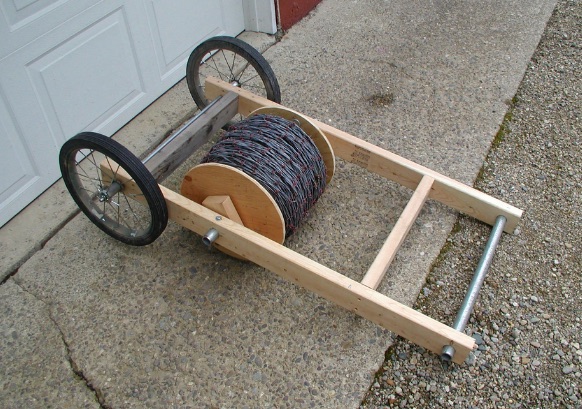

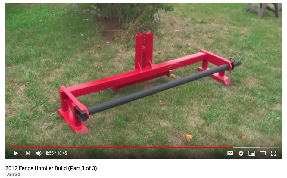

Make one using this pattern, but lighter, and with a pulling handle instead of a 3pt hitch.
A wide, U-shaped frame, axle, and handle.
Fence Unroller Build (Part 3 of 3) - YouTube
Like this, but wider.
