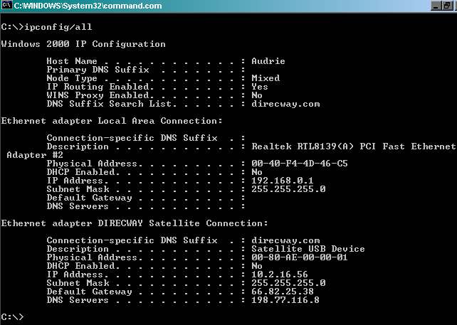

I noticed the DHCP settings are different on the 2......I have no idea if that would matter though.

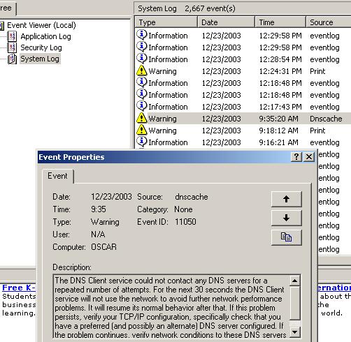

Something else to try is to boot Oscar with the Windows2000 CD in the CD drive then specify Repair. There should have been an error message generated when the Server service failed to start. /forums/images/graemlins/confused.gif

Set the DNS server the same for Oscar as you did for Audrie.
You have Oscar looking for DNS info on Audrie and it is not set up as a DNS server
Billk /forums/images/graemlins/confused.gif

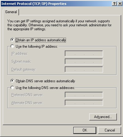

Jerry, each PC is set up to use DHCP. Which PC on your network is the DHCP server? Typically, in a home/small business the DSL/Cable Firewall/Router does this.

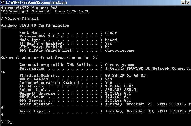

<font color="purple"> Ok, here is the ipconfig/all for Oscar. (the problem machine) </font>
It looks like Oscar was perhaps your Direcway host machine at one time, and have you uninstalled the Direcway software from Oscar?

It appears that Oscar is set up to get his IP number from Audrie and his DNS information from Audrie.
Now look at your system log message again. It states that the DNS Client service could not contact any DNS servers.... Oscar thinks Audrie is a DNS server. My guess is she isn't set up to be a DNS server. Make sure Audrie is up and running, change Oscar's DNS setting to the same IP number that Audrie is using for DNS(198.77.116.8), then reboot Oscar. See if this works.
FYI... 198.77.116.8 appears to be the name server for Direcpc .
ns.direcpc.com 198.77.116.8
