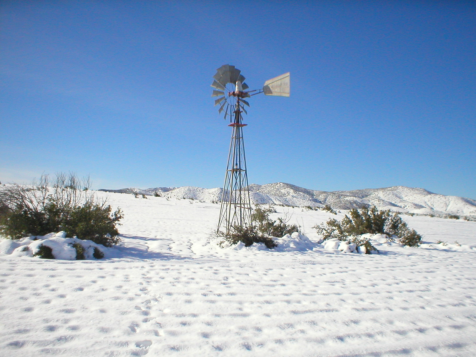

My mill IS our source of water, not up for ambiance. My brother and I put it up and maintain it. Sorry that I was not technical enough in my simple explanation. :rolleyes:
Oh and as can be seen in the picture, a great reason to not have a wood tower. ;)

My mill IS our source of water, not up for ambiance. My brother and I put it up and maintain it. :rolleyes:
That's a great picture and a good reason to have one or more. Some owners have tanks up in the tower to deliver a reasonable amount of water pressure. You must raise the pump outlet or have a secondary spout on the drop pipe. BTW: There is a seller on eBay who has new and used parts for Aermotor and lots of other brands and sizes of windmills, including tower parts. Keep yours oiled and check the governor spring regularly. I use rubber tarp straps as a backup on my Flint & Walling mills. They sag when the steel spring is good. When they have tension in them, its time to climb.
/ Windmill plans?? #28
The tank in the picture is just for the animals. We have a 10,500 gallon tank 75 feet in elevation up the hill about 3000 feet away. My brother is a dealer for Aermotor and Fiasa mills. Parts are no problem. We actually have another 12 & 16 footer that need to be put up sometime in all our spare time. :rolleyes:
A couple of more pics. :cool:
