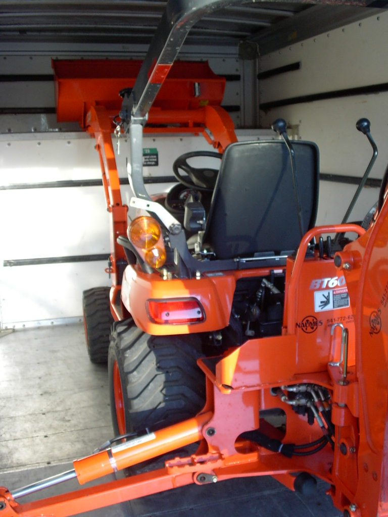

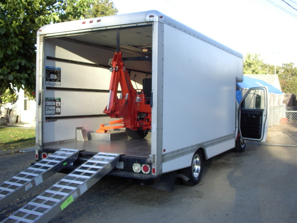

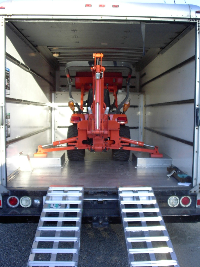

The thing here is;) is to be able to get in it get there do the job then poof your gone. like going to the back woods cabin or going up town to the doc's place to dig that hole his wife needs?lol and now that gas and diesel here is 3.00 and 3.46 gal Diesel :mad:. My box van works good but its diesel and get's maybe 7 to 10 mpg :( the sammy would get 20+mpg. I was looking at this to power it Harbor Freight Tools - Quality Tools at the Lowest Prices or may be a LOG SPLITTER set up like Harbor Freight Tools - Quality Tools at the Lowest Prices just for the tank,motor,pump set up..
