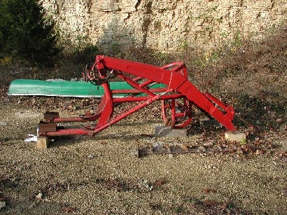

OK, I've finally got some pictures. the bucket isn't attached, but does come with it. Does this look familiar to anyone?
thanks

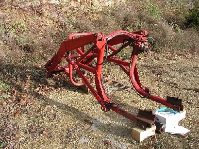

another picture

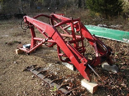

last one

Check the serial#, do some research, and buy a tractor to fit (MF230 or others).
I picked up a loader for $800 and it cost me that much again to install in materials. 4" sq tube subframe to axle, mount plates, crank drive hub and driveshaft, fitttings and hoses, bolts weld rods etc add up. I didn't include my labor, which would have probably added another $800.
   / Will this FEL fit onto a differnt tractor? #18
Somewhere on it there is a serial plate. This will identify it & you can then go from there. If it was made by a cmpany that makes tractors, then likely it will be harder to convert to other tractors. If it is a generic loader brand, then it will be set to fairly easily convert to different models of very similarly sized tractors. Look on the main frames, hidden a bit, get in on the paint if it's a new paint job. Gotta look hard sometimes....
Likely those unpainted rear brackets, and somewhere up front some brackets will need to be remade to connect the tractor & loader together.
Your new tractor will need to be the right size, and it will also need double-acting hydraulics.
Best anyone can do with the info you have provided.
The folks at ytmag.com might be able to figure out a brand from your pictures, but often several models look similar so you still need the serial plate....
--->Paul
